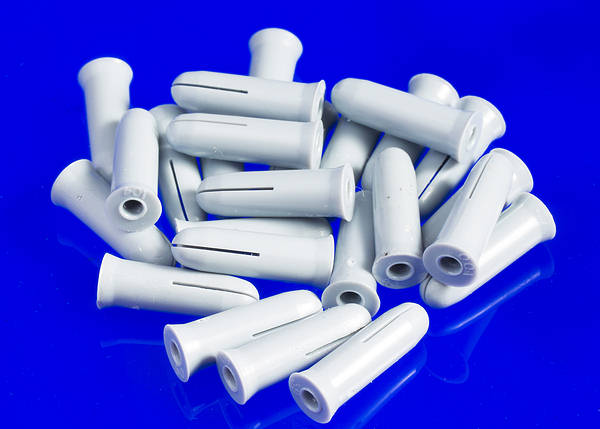

I think Im going to go with the wall option.... puerly as it allows me to get that job out of the way before the stud wall. Will bang some insulation tape on the drill so not to go too deep.
It's not really the depth of the hole which is the issue. The important thing is the 'width' of the hole. If the plug is not a fairly tight fit in the hole, it will not 'grip' when expanded (slightly) by the nail.
Just use longer nails in the clips into the mortar.
That really depends upon the mortar.
In my house, in a similar fashion to the situation with the plaster, the walls have one of two types of mortar - one type is like concrete, at least as hard as brick and all-but-impossible to get any sort of nail into. The other type is like sand, and the only effect that using a longer nail would have in that would be to make more of the 'sand' fall out ;)

If its quite a sizeable gap between plasterboard and brickwork then a few loops of all round band screwed and plugged to the wall is another solution
That's excellent. I didn't even know these existed!
As I've mentioned, the important thing about using them is that the hole one drills has to be small enough that the plug is a fairly tight fit - the nail is only able to expand the plug slightly, so that, if the plug is loose in the hole, it may well not expand enough to grip.
