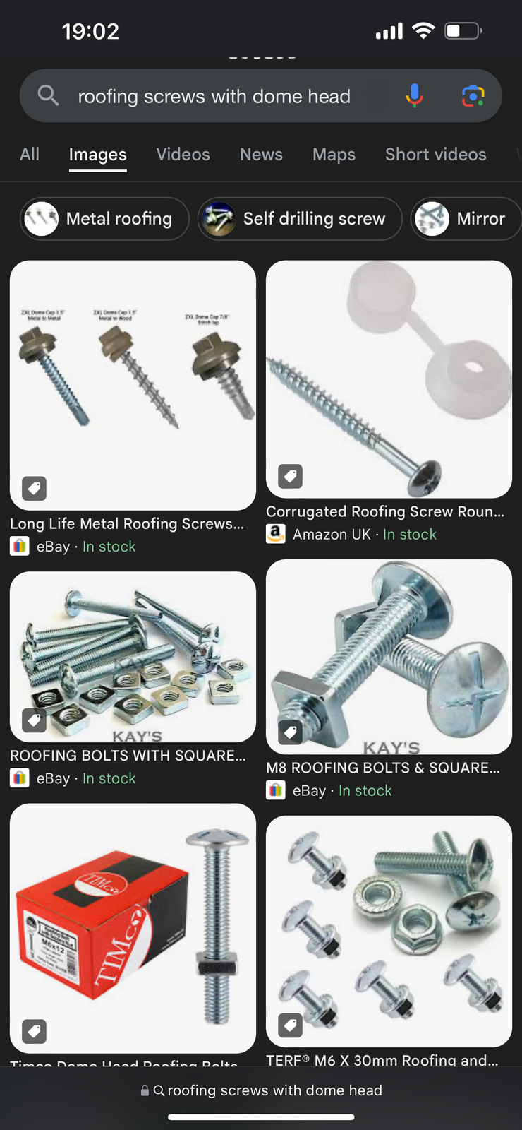

Not sure which roofing screws you had in mind. Google throws this up for me and they’re all a security risk, given their heady types.

Roofing bolts - as seen in your pictures - double slotted heads, bright plated, various lengths, 6 or 8mm. Usually supplied with square nuts but the threads are conventional metric.

Would these do, or do I need a straight screw driver head?
Also, it seems counter intuitive as to why they can't be undone from the outside and no are they advertised as that. I assume this is something you know from experience but intrigued to understand how it safeguards against this and a hex bolt doesn't. for instance.

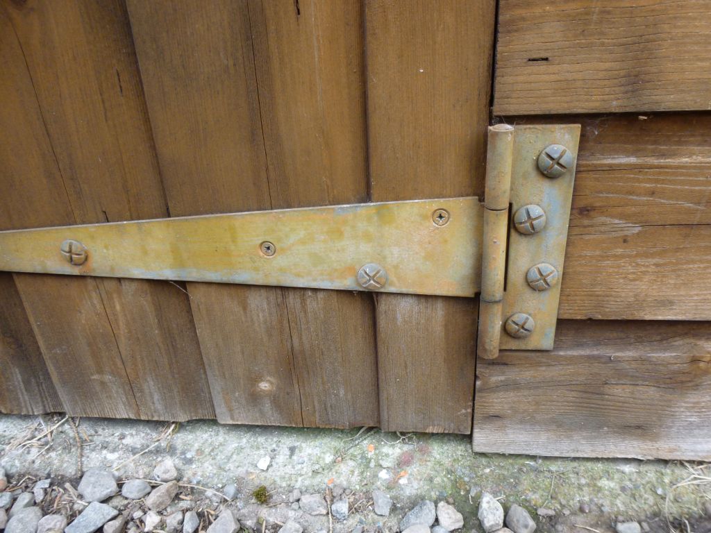

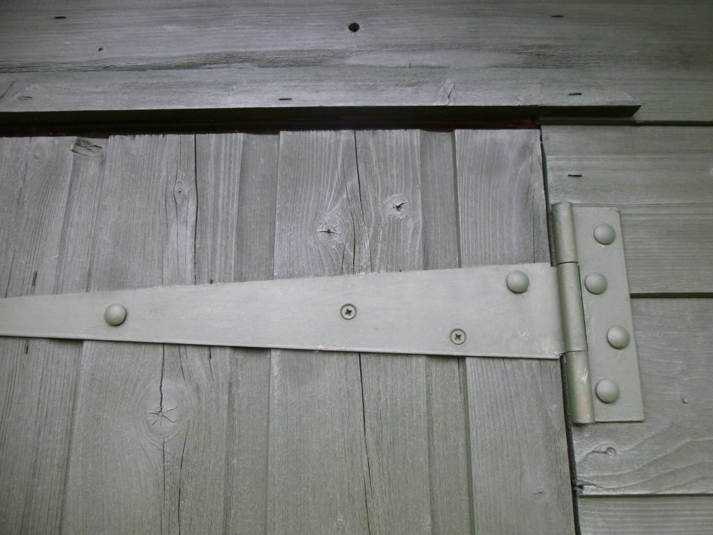

Don't overthink it, you're just bolting the hinges on. I've got some with coach bolts, some with roofing bolts. You don't need to have bolts in all the screw holes. If somebody wants to break in they could cut the (heavy duty) hinges in seconds with a battery grinder, or cut through the wood
