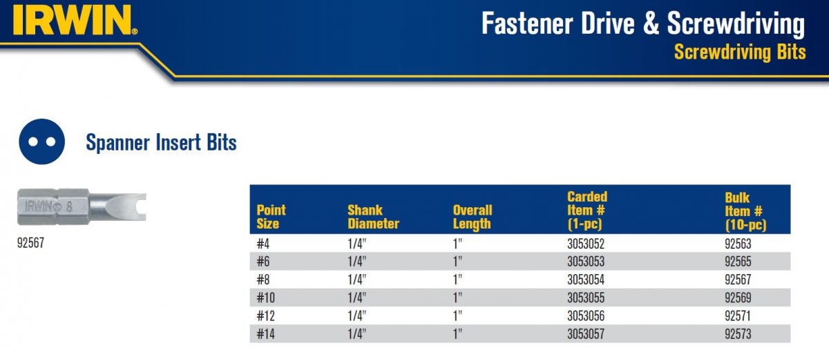

Looking for a bit or a screwdriver with an end like this, its for security screws used on the Rail network, the holes though are 6mm centres roughly, and wider than any i can find.
Thanks in advance
Found this, anyone know what ones 6mm centres TH8?
images
The ads I can find advertise the dimension as a "centre to centre" distance.
Were any aprox 6mm centre to centre though, i can find lots of kits etc with smaller ones
I have up to Th10 and there all to small

Looks like i may have to for my own use, i had thought off that, then thought surely they will be somewhere on the internet, I cannot find one anywhere, mind you if I knew what its code was it may help :)
Nowhere seems to state the dimensions, i may get a TH8 cheap bit and see as eventually we may need about 10

uk supplier of the 12 or 14 type
Yeah, that doesn't really seem to exist in the UK. Have you managed to accurately measure the screw head to try and work out whether it will be a #12 or #14 that you want?
These guys will ship 5 of the #14 ones to the UK from the US, but the P&P is pricey...
http://www.ebay.co.uk/itm/172256562851
It's maybe worth asking UK Irwin stockists whether they can source them from that part number, seeing as you want 10 of them.

These are on the diffusers, self tappers actually, they look like a number 12 screw so possibly why the keys are called Th12 etc.
Stratford station for example is riddled with them, to access to relamp.
images
I never measured that accurate, but looking at the measurements rsgaz found my 6mm centres hovers between a 12 and a 14, and im guessing wont need a lot of work on site to adapt to fit,
I dont have a spare screw to make one and try so I really need to go prepared on the night. machine tools wontbe acceptable on site, so it will be old school handsaw and file
