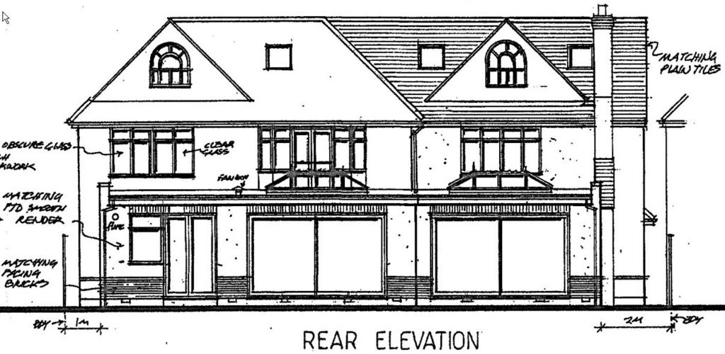

Out of interest 18-40k is a massive amount, what work is involved, how many windows, doors etc are there?

As asked 18-40k is a huge amount, How big is this mansion/castle?
There's also a 4 or 5 side windows not shown.
We'll probably go for Schuco aluminum sliding doors which is approx £9k. Another £15-20k depending on if I go for grey 7016 upvc frames and also including 2 large roof lanterns 3x1.5m. Doesn't include the front doors. Quite a few options to consider.
Nice place. Good choice of aluminium for the doors schuco are nice but pricey

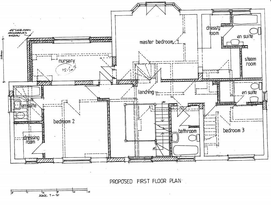

Also any suggestions on whether the centre round feature window at the front of the house should be clear glass or frosted/sand blasted privacy glass? When looking through the it at street level, you won't be able to see in the bedroom immediately at the back as the door entrance is to the right.
The feature window is at the front of the first floor landing as shown below to give you an idea.
Totally up to you, If you have nice views you will never see them if you have obscure glass.
Could you fit curtains?
