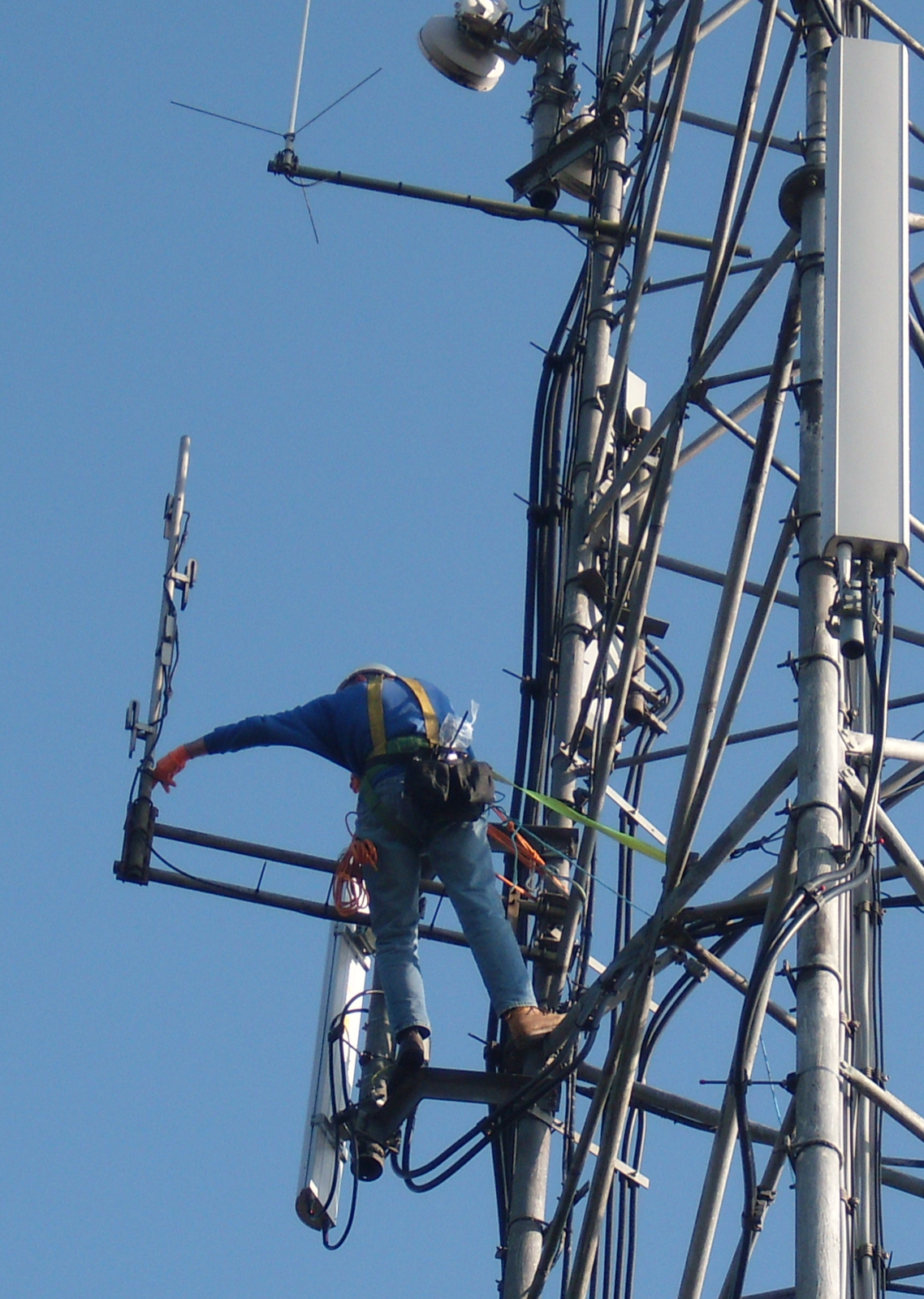

Not as many as birds that peck and eat, various bugs that like to build their houses in little gaps and extremes of hot and cold, wet, dry and windy etc. Apart from the act of digging I'd much rather be working on and/or repairing the minor works required underground. Yes I do both and I can state from experience that a grotty PVC tape joint will generally last a lot longer buried U/G than tens of metres up in the air. EDIT: There is also a vibration issue to contend with aloft.
For those who have not climbed a structure of this ilk (often on top of a hill of some sort) getting above ground level turns hostile very quickly. Even on a hot summer day I would expect to wrap up very warm as the temtarature drops rapidly.
But as is often the case this is getting a long way from the topic of self amalgamating tape.
I made a big mistake with this job:
I unexpectedly had to replace weather resistant cable ties which had failed in about 3 years and refix a feeder to the mast. I didn't have overalls and coat and I managed to book a 1 hour slot of the mobile cell switched off. Ss it was a hot day (ground crew in shirt sleeves) I climbed wearing jeans and T shirt & jumper. Big mistake, I was frozen and shivering by the time I'd finished.

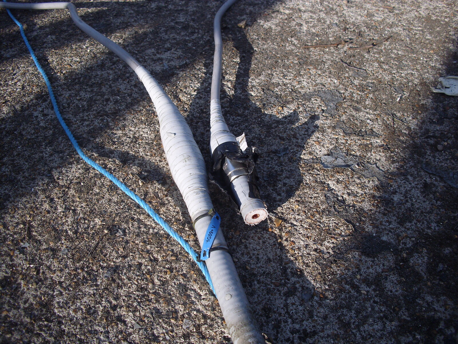

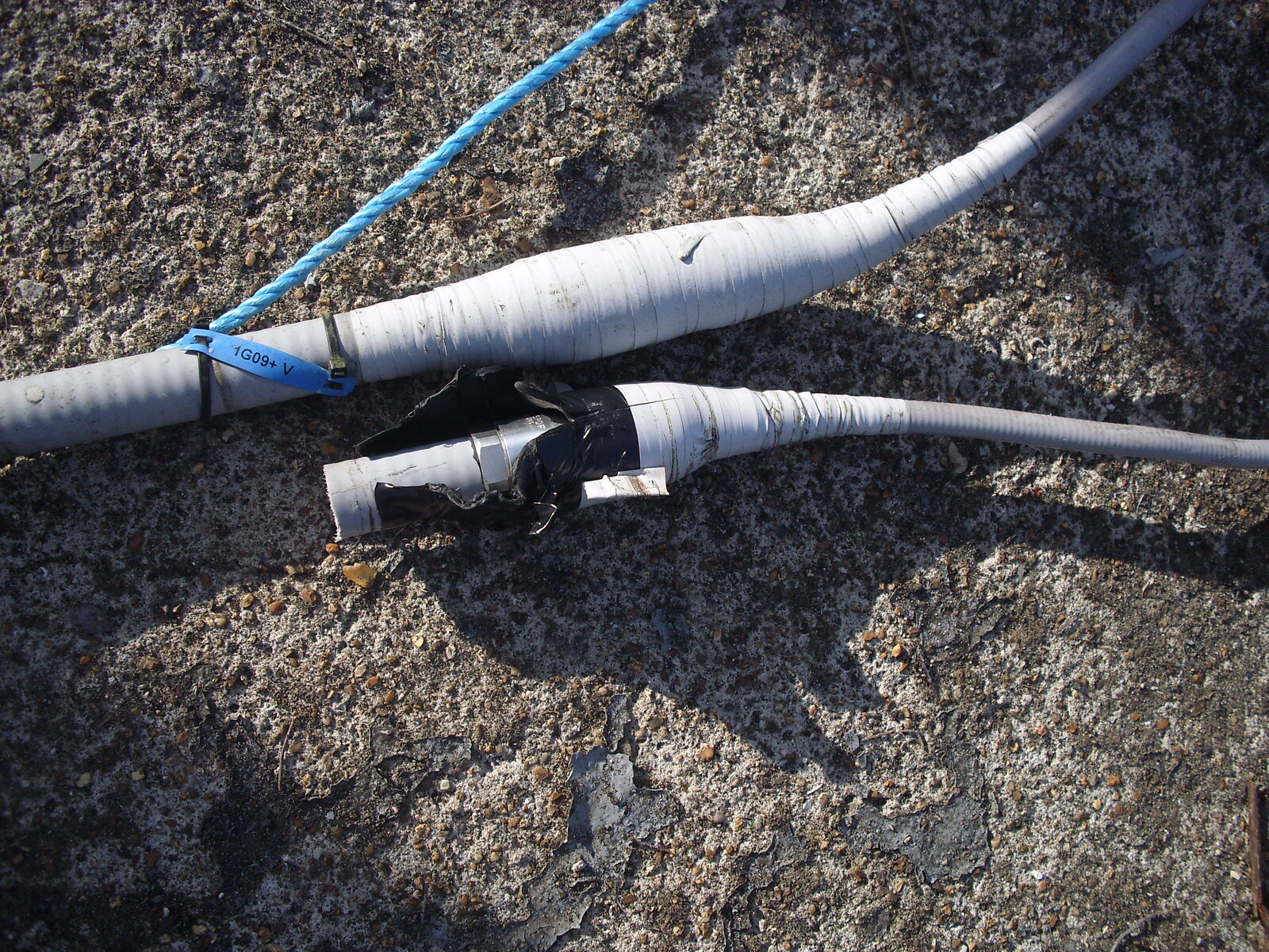

Today I helped clear redundant debris from the above pictured mobile phone mast.
This is how self amalganising tape is used by properly trained, professional aerial riggers:
I know it doesnt show very well but that's a single layer of PVC tape, sticky side out then SA [or could be SV] tape to about 3mm thick, 2 layers of black PVC tape and lastly 2 layers of grey PVC tape.
These coax ofcuts were the last remnants of the Orange system installed there in the early 1990s so around 27 years old, the cable and plugs look like new inside there.
