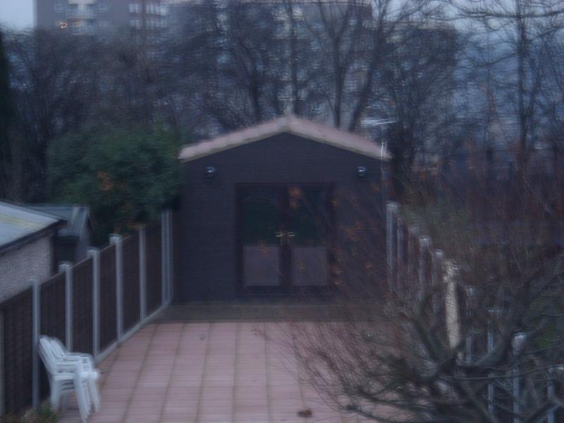

Hi Fellas, here is todays work, what a lovely day for it!
Hate to spoil the fun but have you thought about planning permission due to the dimensions of your shed. Envious neighbours may think of it before you do. Also check the distance from the boundary lines. :!: :!:
i wouldn't worry too much about planning permission

Yup I had already checked that I wasn't in contravention of planning and building regs!
Believe it or not the garden is actually 100ft long, although the pic makes it look smaller. The next nearest house is next door so it's not even a nuisance to anyone else.
