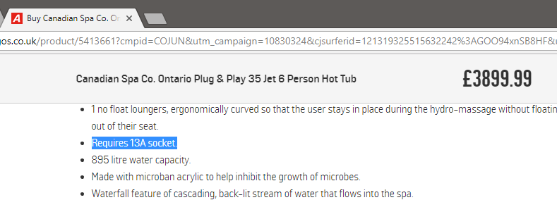

On the other hand, the product details include this:
so anything is possible.

To be fair, if they do sell some hot tubs with 13A plugs, they are probably pushing that plug to its limit - so you probably should have calculated on the basis of 3kW (i.e. about 6.8 hours).
