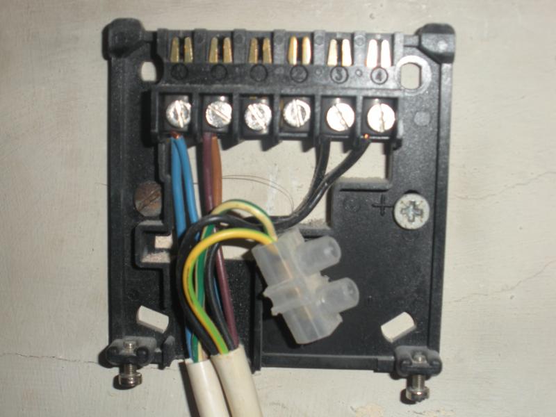

I know it has been a long time since the last post but for many reasons, mainly laziness, I have only just got round to trying to change the wiring. Back in May I was pretty sure that I knew what I was doing as it was simply a case of a missing wire to the HW OFF terminal, but now when I went to do it at the weekend I realised that I haven't got a clue.
I purchased the five core plus earth cable from B&Q as advised in the post of 21st May. Only problem is there is already a five core plus earth cable wired up to the backplate and I don't know if the additional five core cable is the correct route to follow to make the HW turn off in order to have seperate HW and CH, or if I should be using a different cable.
I have taken a photo of the backplate to show how it is currently wired. If the additional five core is needed, could you tell me how the wires should be put in the backplate and the junction box. If not, what wire is needed to complete the job.
Any advice much appreciated.
I purchased the five core plus earth cable from B&Q as advised in the post of 21st May. Only problem is there is already a five core plus earth cable wired up to the backplate and I don't know if the additional five core cable is the correct route to follow to make the HW turn off in order to have separate HW and CH, or if I should be using a different cable.
Got your comment ;)
There are two cable connected to the backplate. Do you know where the other end of these cable are? If so are the green/yellow earth wires also connected into a loose terminal block, i.e. not used?
If they are, you could use one of these wires as the connection from terminal 1 on the timer to the cylinder stat yellow/valve grey terminal. The wire in the right hand cable would be the most suitable as it appears to contain the two black wires connected to terminals 3 and 4.
If you do this, you should put some red insulating tape or sleeving round the wire at both ends to indicate that they are potentially live and not earth wires. The remaining earth wire should still stay in the terminal blocks for safety.
I don't normally recommend doing this as it's against the "rules". But there are times when it makes sense to break them. ;)
PS This way you won't need to use the 5-core cable. Return it to B&Q.
Have changed the wires and all seems to have worked, we now have seperate central heating and hot water control.
