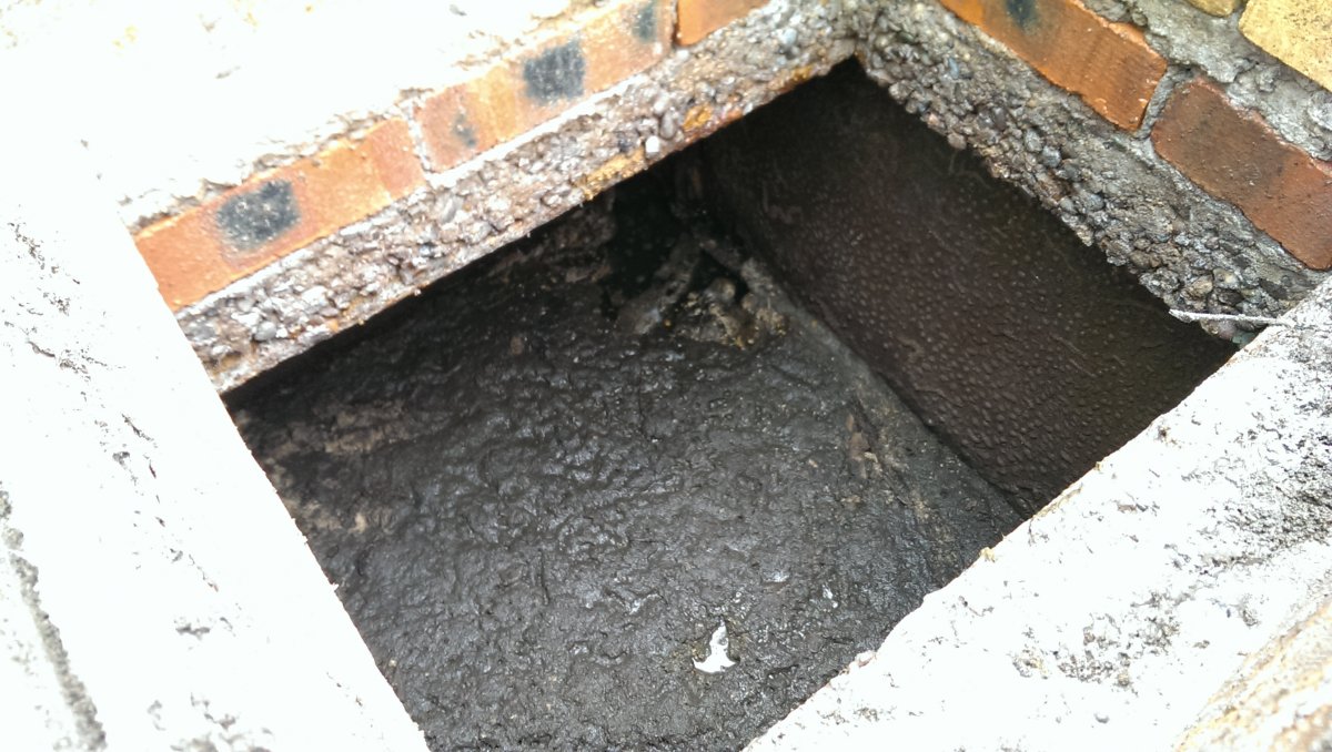

Hi, I have a septic tank in a house I have recently moved into. I have just looked inside to find that there appears to be a thicker than usual amount of Scum on the top. I poked a stick through it and the crust was pretty hard.
So it got me wondering if this means it's time to pump it out? Below the Scum is a deep level of water and what feels like very little sludge at the bottom. The second tank is full of water with no sign that the scum is passing through from the first tank.
Any thoughts? What's the tell tale sign that I need to clean it? To be honest, I'm not wanting to fork out £250 if I don't need to.
Cheers
Just tried uploading a pic of the first tank..Hope it works. Oh and apologies if you're squeamish!

I don't think that's really a huge deal, but of course you don't know the depth of the solids down below. It looks like the property may have been empty for a while? More importantly, have a look at the outlet chamber, where the liquids drain into the land.....that chamber should be empty with no solids present.

The scum at the top must be about 3" thick and can best be described as a big floating cow pat...... Poking through with the stick shows about 3 foot of liquid. Then I hit something hard...pushing down hard on the stick breaks through something to give about an extra 2" of depth.
The second chamber doesn't appear to have any solids, just stinky water!
Sounds fine - just monitor the second tank for solids - every 3 months or so.
Maybe the previous occupants of the property have been using additives to assist the digester action of the tank? This can often produce a crust as you see.
No matter.....keep an eye on the second tank - this will be shallower than the first one and should only be full of liquid as the solids remain in the primary tank. At the end of the day you don't want solids going down the outfall drains so it's worth keeping an eye on that as the days go by.....at this stage you don't know if the outfalls are fully working or not.

A crust on the top is perfectly normal, and in fact shows the tank is working as it should be. Keep detergent and chemical use to a minimum, and ideally water and the 3 P's only (that's pee, poo and paper), to discharge to the tank, and certainly no rainwater or discharge from a water softener!
There should be 'dip pipes' on the inlet and outlet to each chamber, to allow the effluent to enter/leave the tank under the surface, thus allowing the blanket to form on the surface and the bacteria to happily carry on their work of breaking down the waste, below the surface, anaerobically. A common problem is when the dip pipes fall off, so flows in and out keep disturbing the surface, preventing the blanket from forming, which in turn affects the breakdown of the sewage, and the quality of the final effluent discharged to land.
Desludge as required, I'll echo the others, its the quality of the final effluent that matters. If there is too high a concentration of suspended solids, the soakaway/leachfield will soon clog up, rendering the whole system useless. If the clarity of the final effluent begins to wane, time to have the tank desludged.
Lastly, under NO circumstances ever attempt entry to the tank after its been emptied. Hydrogen Sulphide may well be present, a gas which is heavier than air, deadens the sense of smell at dangerous levels, (which aren't very high!), which can, and has, proved fatal on several occasions. A gas monitor, and Confined Space training are minimum requirements for working in such an environment.
