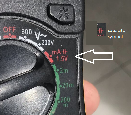

I then decided to test the caps resistance via the meter and on each received a '1' value. Does this indicate that the caps have blown?
You need a meter with a capacitance range.

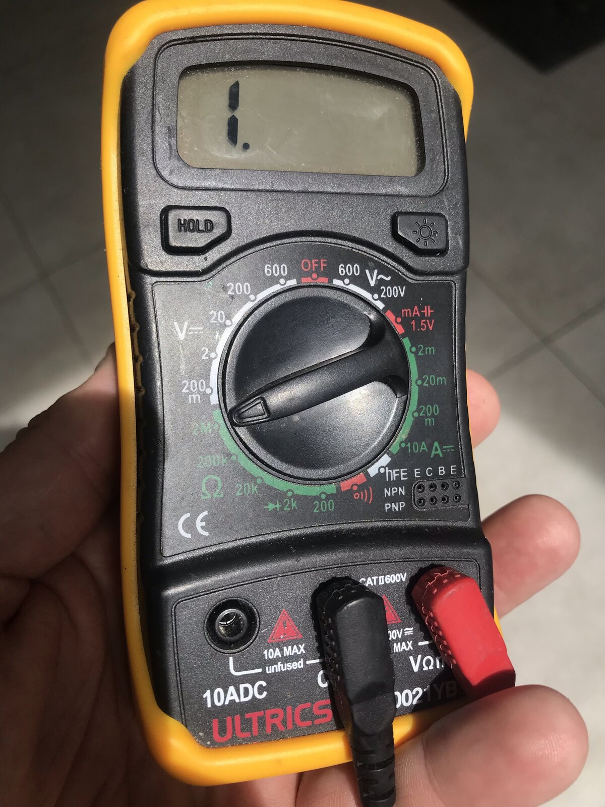

Which range is your meter set to..... What does a 1 signify ?
This is how I had the meter set:
it reads 0 when together and 1 when apart.
I've just tested both of the caps via that meter setting Bernard and received no reading from either?

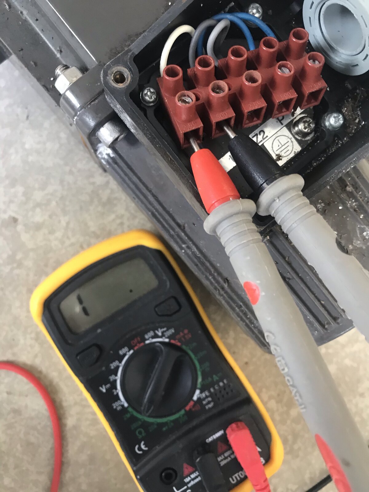

You should get a resistance between U1 andU2 run winding
and U1 and Z2 start winding
Touch probes together to check ok 0 ohms
Test between U1 and U2 Reverse probes and recheck..... Repeat with U1 and Z2.
Okay for the "Test between U1 and U2 Reverse probes and recheck....." - I receive a '1'
for "Repeat with U1 and Z2". - I receive moving digits counting to zero
