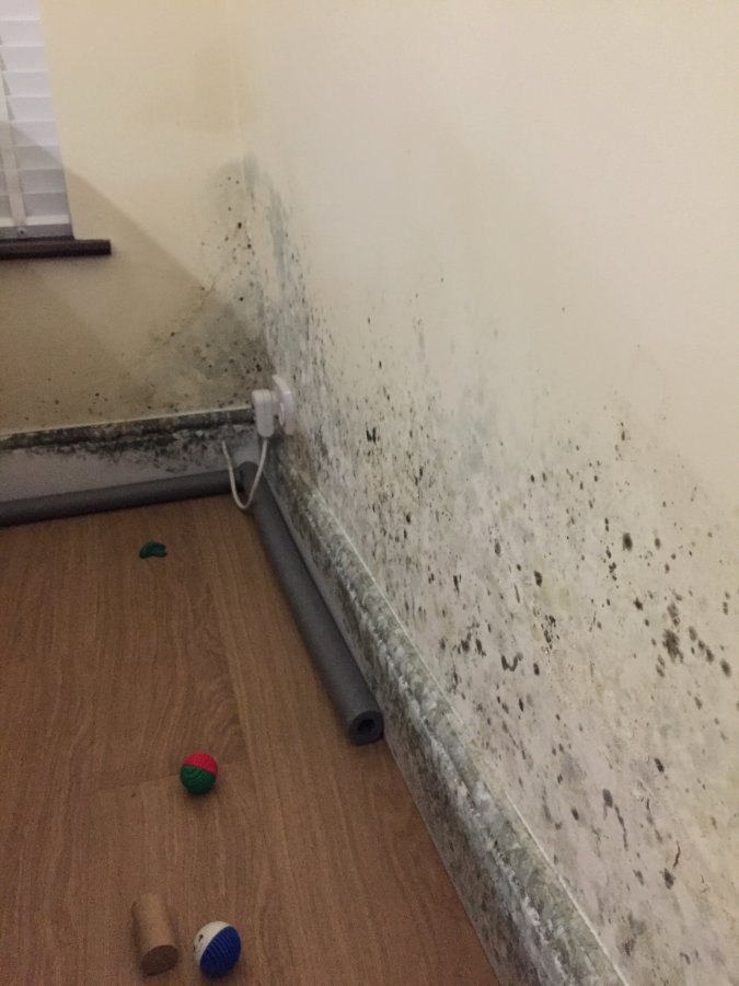

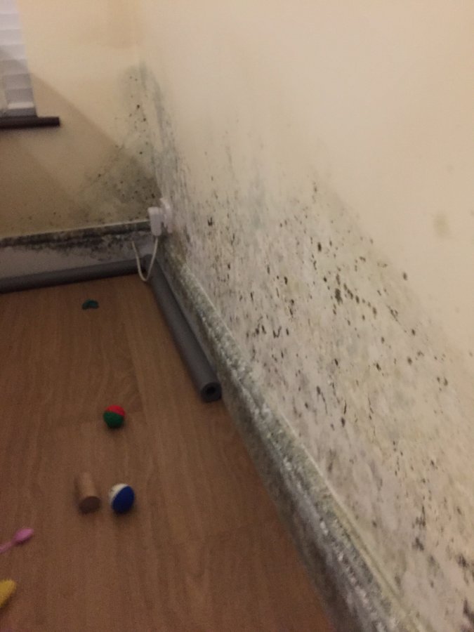

I am currently having a serious mould problem behind my sofa and was wondering whether I could pick some brains on the forum to help solve the cause.

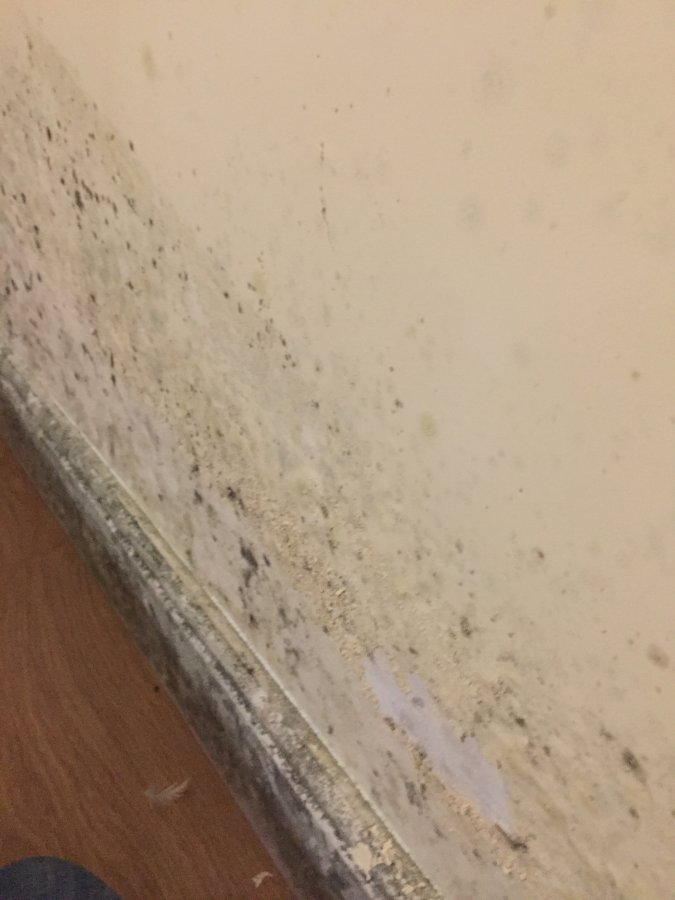

I went to clean behind and underneath the sofa today but found a large amount of mould on the skirting and the wall itself. I re-caulked the skirting about two months ago and saw some minor mould when I did this but just cleaned it off and it was no problem. The amount I found today is in a completely different league. The paint has bubbles in it and is peeling away from the wall exposing the plaster itself, the plaster does not look wet or damp and is in no way discoloured.
I suspect the cause of this is lack of air circulation, the sofa is right up against the wall and we have put some pipe insulation under the sofa to prevent the draught that comes in, in retrospect may not a been a great idea. I'm hoping it is a simple matter of limited air flow and won't require any major work.
The whole ground floor has had a chemical injected damp course applied just under a year ago.
I've uploaded some pictures of the affected area. In the meantime I've put some pots of rice behind the sofa in the hope of extracting some moisture.
Thanks in advance.

Yes must be stagnant air near a colder wall, the moisture in the air condenses out when it diffuses over there. Maybe the draught was drying it out before.
You can try the usual things, use fans when cooking/showering, ventilate daily, don't dry washing inside.

I'm pretty sure this is what happened. We live in a semi built in around 1895 and the slate damp course had apparently been breached. In fairness there was damp up the wall, to about 1m, that was causing the wallpaper to peel of and a lot, if not all, the plaster was blown.

You have classic "Black Spot" condensation but there also appears to be salt signs from damp penetrations.
Is the wall in the pics Dot & Dabbed or solid plaster?
Did the D&T Co. use render or gypsum plaster on any walls?
Are the walls solid?
Is the floor solid? Is that a wood or vinyl floor covering?
Is the outside rendered?
FWIW: If you have children then keep them away from the mould/room.
Isolate or unplug the elec outlet - its at risk of arcing due to moisture in the box.
