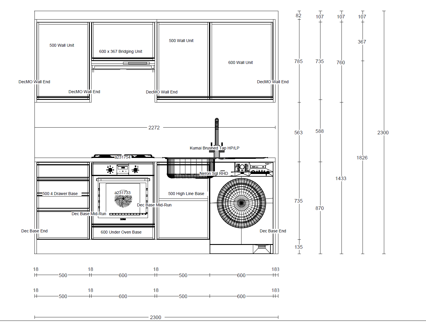

I was planning on following this as guide for my heights.
I’ve been reading that I should set my laser level at the cabinet height of 870 when measured from the highest point of the kitchen.
If there is significant slop in the kitchen, I assume I can end up with a plinth gap exceeding 15cm? I assume I can get away with a certain amount as the top of the plinth isn’t visible unless you are kneeling down and looking at that level. Is that the general thinking and based on this how much tolerance do I have?

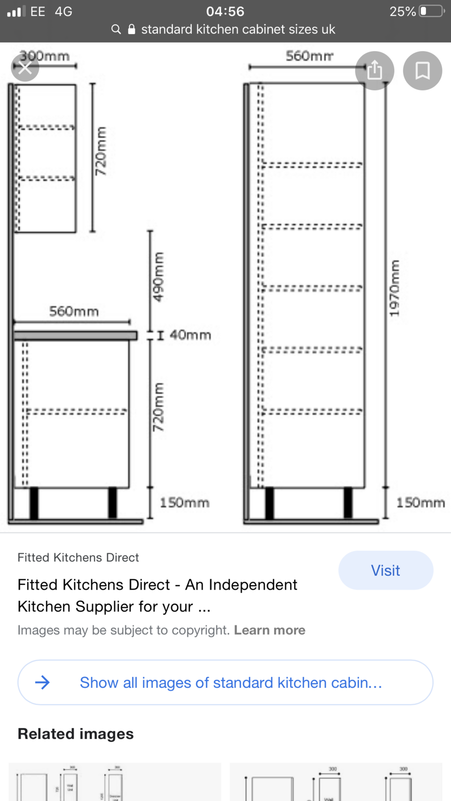

This suggests that my plinth gap should never exceed 14cm and for a sloppy floor, there would always be a cut to the plinth.

worktop thicknesses vary between 25-50mm , so 870mm is merely a suggested height. 10-15mm either way to allow for your uneven floor and plinth fitting won’t make a difference.
