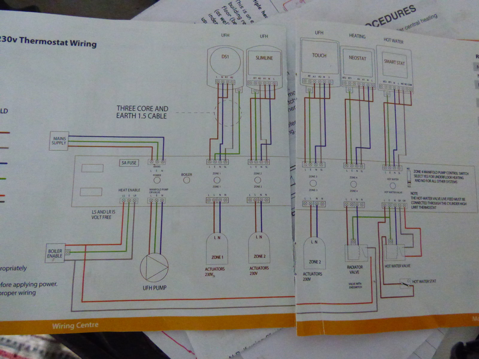

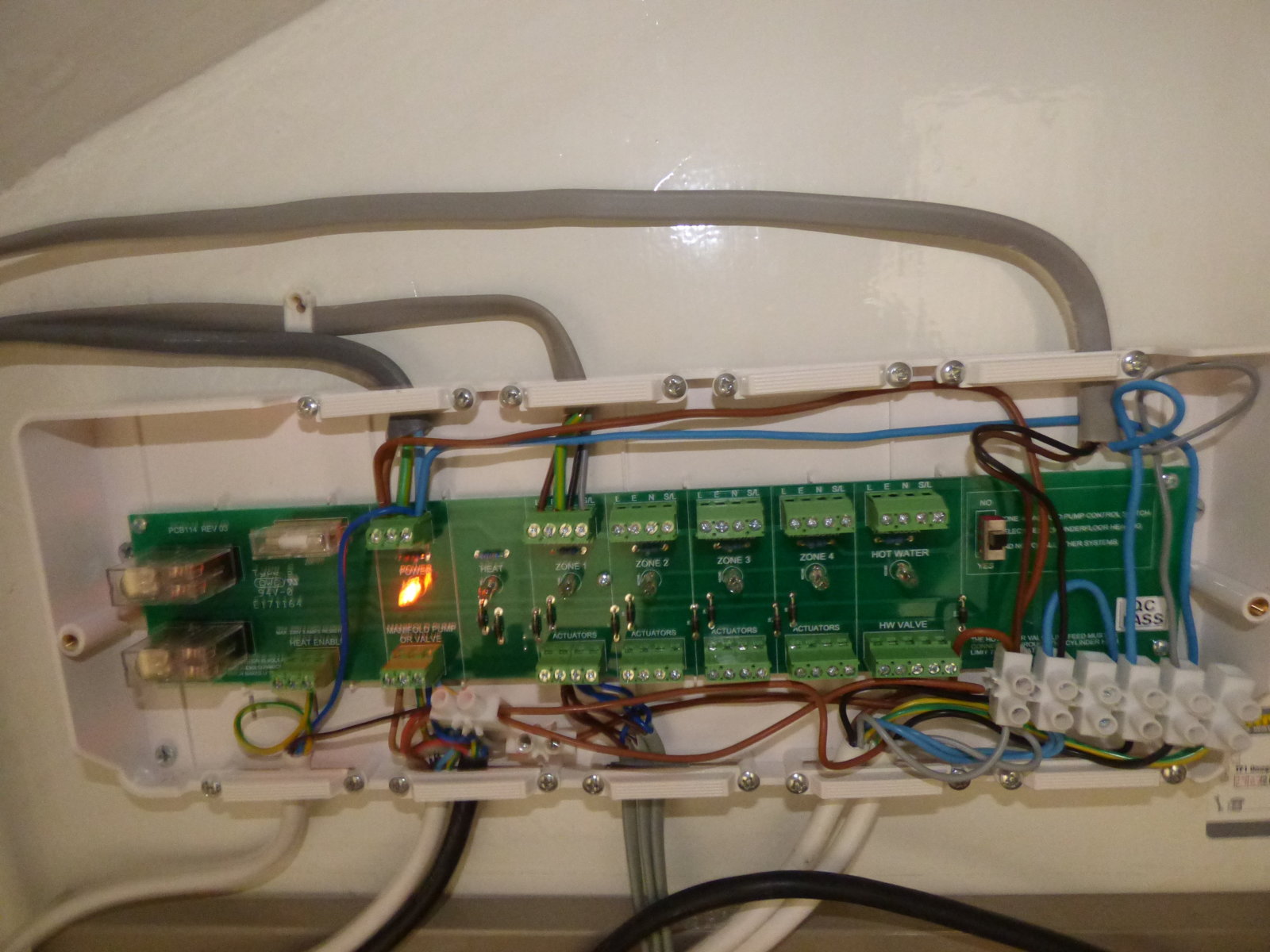

ok ive had a look , what ive done before is ok for just simple switching of pumps, valves and old boiler
with just L.Eand N going to a chock block . that was just about within my capabilities or not , but its done and works to a point .
I wasnt able to figure out how to connect the wiring centre with the old boiler properly so that's why its ended up as it is .
now ive got a new boiler it must need to work differently . I don't expect to be told how to do it for safety reasons.
but i would like to understand the principles of what needs to be done .
new boiler is vaillant eco plus 430
I think i need to ditch the chocolate block and use volt free terminals and the rest of the wiring center?
does my boiler have volt free ? the gas guy took the instructions so i cant check .
Is the boiler meant to have L.E.N being switched by zone valves ? so its off until there is a call for heat .
or is L.E.N. supposed to be permanent boiler stays powered up and switching is done in the wiring centre relays ?

AAAHHHH thank you Roger thats really helped me get a clue :)
so ive got a zone valve so the actuators can go
(as its all 1 zone) and the wiring can stay as is , all be it a bit more tidy .
Should be a thermostat fitted.
And no need for actuaters when its serving one zone.
thats what i was trying to deal with , but my poor brain just couldn't fathom it out .
the wiring diagram doesnt go far enough to explain its relays and what they are supposed to switch .

anyway , ive run the bloody thing again ...
put the mixing valve on 45c
room temp was 22c
put 24c desired on the hive thermostat and watched what happened (this time i closed the windows)
click! things come on pump zone valve open
live goes to actuators i still cant see movement, after a minute of so the flow regulators start indicating flow. i can see why i don't need them now :)
no pressure build ups or anything, there were some air noises so i bled above the pump and also the pump upstairs in the airing cupboard.
boiler cuts in and out a bit at first, with the water flow indicator flashing when it does. because of the slow opening of actuators i suppose.
room temp crept up to 24c and click it all went off
floor temp was 29c at that time .
an hour later floor temp 32c and room temp 25c
I think its working better this time .might have just been air
