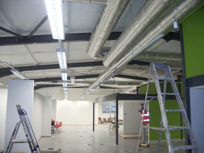

Bas you need to be looking for lighting trunking.
We did an installation in an office about five years ago using 2" x 1" galv steel lighting trunking.
You can see the profile in the top right of this picture. We bought it as standard galv trunking and had it powder coated white to suit the customers requirements.
It was purchased from city electrical factors. It will be a special order item, but they should be able to supply you a single length.
