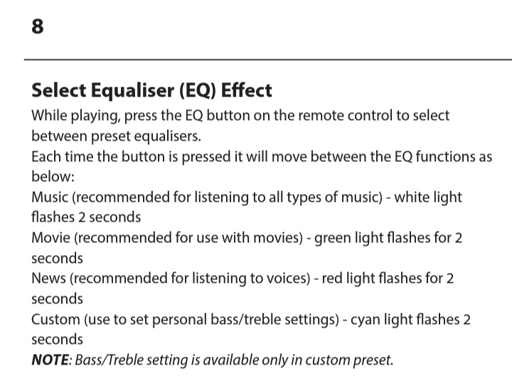

A feature of this soundbar is that there are no visual facility to check the equaliser settings. The only indication available is an LED light on the speaker which changes colour the colour being generated by varying illumination of multiple smaller leds, the LED base colour being Red no matter what Equaliser option is selected. Thanks for your help.
So the led doesn't change colour at all?
That doesn't sound right.
It looks like you need the cyan light to enable custom EQ and enable the bass/treble adjustments.

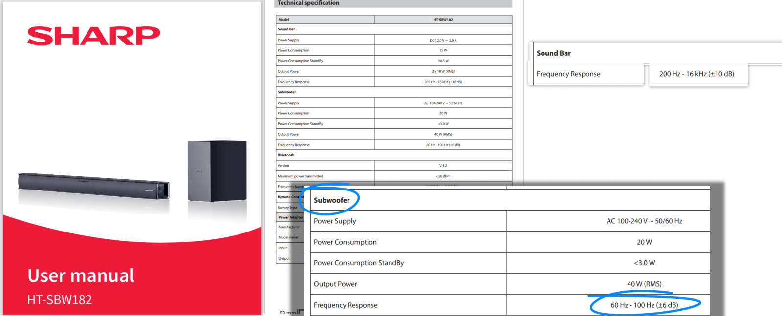

The Sharp sound bar is £90, and that includes a wireless sub. If you breakdown all the costs, stuff such as resellers profit, VAT, transport, support costs etc then there's not really a lot left in the kitty to make a sound bar that will sell for £90. That doesn't stop them being made, but it does put these products into perspective in relation to an OLED TV. That's a product that's at the other end of the spectrum. OLED isn't the last word in money-no-object TVs, but it's pretty much up there.
The designers of the Sharp were fairly sensible in keeping this a basic 2.1 sound bar. There's no support for Dolby Digital or DTS, so it's worth checking that the TV and any sources are set to Stereo PCM rather than Auto / Bitstream or Dolby.
The sub has quite a limited frequency response; just 60~100Hz, and even then the sound measurement allows a lot of roll off (6dB) which reduces the range of useful audio even further. Try placing the sub in a room corner to get a bit of bass boost.

The frequency response of the Sharp sound bar at 50-100 Hz (+/- 6db) is a bit of a give away but is clearly referenced to the Bass Frequency Response and does not address the Treble and that should be in the 15kHz area.
I don't believe I referenced the whole sound bar as 50-100Hz, just the sub, and I gave the 60~100Hz figure quoted in their user manual specifications. The main sound bar frequency response is 200 Hz ~ 16kHz, but it +/-10dB, so a bit of a gap between the sub and the bar, and a lot of variation in the sound level across the range. Having said that, the in-room response of most loudspeakers is quite peaky too, so let's not lose any sleep over this.

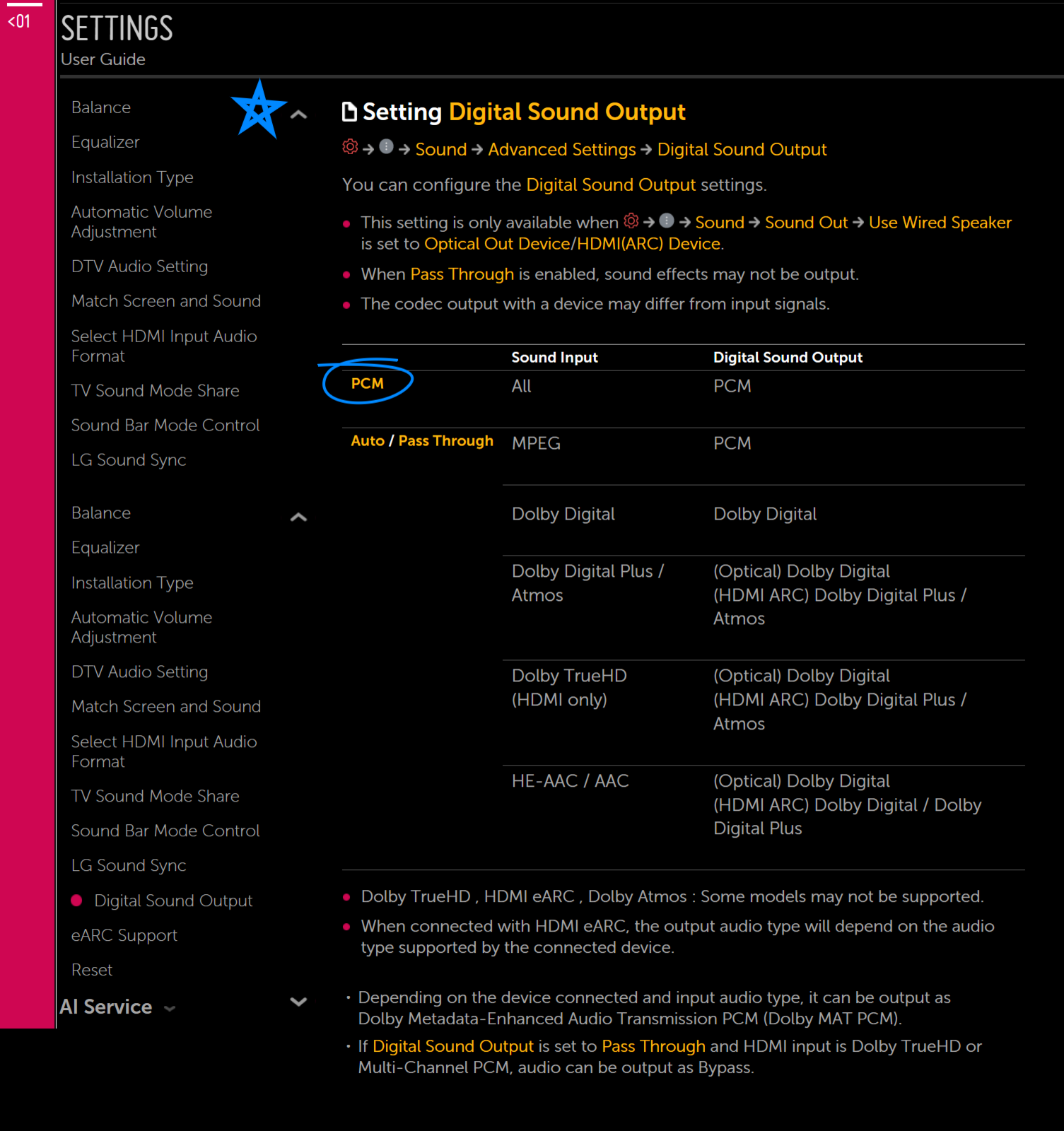

I had a look at the available sound settings on the TV and they are MPEG/Dolby Digital/Dolby Digital Plus/HE-ACC/Auto. In my ignorance I thought MPEG was a video format hence the MP(Moving Picture) reference, clearly I am wrong there. I am familiar with Dolby but have no idea what HE-ACC is all about, so in ignorance I left the sound setting in Auto, Your advice regarding settings and using Stereo PCM is not an option, so what would you suggest I use in that you recommend avoiding Auto.
It would be useful if you'd given the TV model number, then I could be sure of giving the exact info. As it is, my best guess is that you have the OLED55C1 (OLED55C14) model, but that's only a best guess. However, if it is that TV then PCM is an option, though I have to say that the menu choices are context sensitive. You do need to check certain settings before some options will appear.
I've composited three pages from the Web manual which replicates the TV's built-in help menus. The blue star and ring are my additions too.
There isn't an option for the TV to output HE-AAC in the menu list above. That CODEC only appears in the list of sound formats the TV will receive. It is converted internally by the TV to create DD or DD+ for the pass-thru setting, and converted to PCM if the TV is set to that mode.
HE-AAC is the audio CODEC used by broadcasters for digital TV and also used in streaming. It's a more efficient CODEC than the MPEG-1 audio formats used for digital TV. This goes hand-in-hand with the higher efficiency video CODEC used for HD and for 4K streaming.
Your TV and sound bar will be negotiating a common set of audio standards via the HDMI handshake each time the system starts up. It's possible then that the TV sees that the sound bar is only capable of stereo sound, and so the TV is automatically defaulting to PCM 2.0 out. You might want to disconnect the HDMI cable for ARC when the devices are powered off, then recheck the sound menus as if you were using optical. The TV can't detect an optical-out connected device, so whether something is plugged into the socket or not makes no difference to the TV. Run through the sound set-up menus as if your sound bar were to use optical and see if the PCM option appears. If it does, then set the TV to use it. Next, power down and reconnect HDMI. The sound setting should remain as PCM even if the menu option disappears. Double check that HDMI ARC audio out is working correctly.

When I use the Sound Bar remote control to select different Equaliser settings, there is absolutely no discernable difference in the sound with any of the settings although the Sound Bar LED indication suggests the different equaliser options are set, User settings of Bass and Treble should be able to be reset in the 'Custom Mode' of the equaliser but again there is no discernible difference when using Custom Mode and adjusting the Bass and Treble settings.
