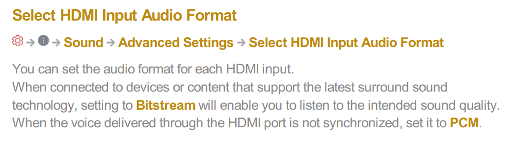

Paper manual. Page 86. The setting you want is PCM.

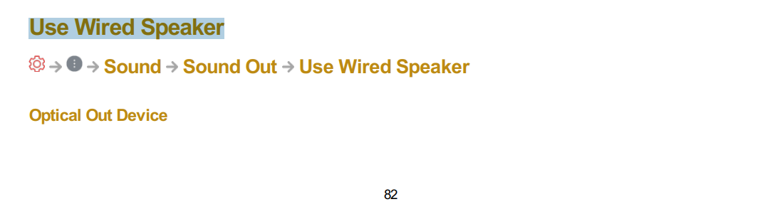

Paper manual. Pages 82 and 83. Use wired speaker, set to HDMI(ARC) Device

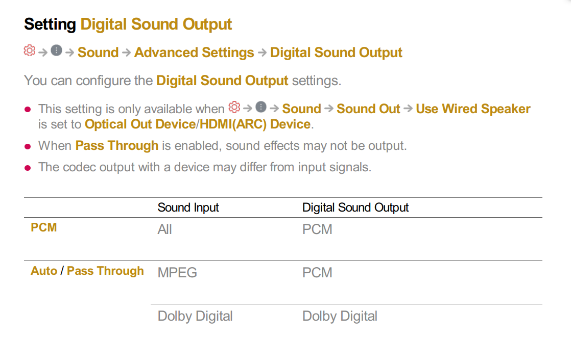

Paper manual. Page 87. Digital Sound Out -> PCM

I had the Sound set to WIred Speakers-HDMI-ARC, but when addressing Advanced Setting, a Digital Sound Option does not display, only the one I mentioned in an earlier mail giving the options of MPEG/Digital Dolby/Digital Dolby Plus/HE-ACC/Auto. The Option for PCM does not appear. Based on our earlier discussions, I tried MPEG which made no difference to the Sound Bar performance.
I have seen that list in the manual as well as in your previous post. This menu relates to the sound that the TV receives via broadcast. It's a sort of parallel to setting the sound preference for a HDMI input. IMO it's less useful though.
You see, with the HDMI sources it's possible to set a maximum ceiling level for the sound format. PCM is the lowest common denominator, and whilst it's good sound, it is also limited to being either decent quality pure stereo, or a form of surround sound that lacks the precision of Dolby Digital. The sound format is Dolby Surround, and it is decoded by Pro Logic processing. Generally, this setting of a ceiling level is done at the source device, and that might be a Sky receiver, Virgin box, Fire TV stick, Freeview recorder etc. One common complaint with sound bars is the audio being delayed when listening to a Dolby Digital encoded signal. Reducing the sound format to PCM often fixes this.
With TV broadcast, your TV gets what they send. There isn't an option to get the broadcaster to send something else. In many cases the broadcast audio format is HE-AAC. The TV decodes that internally, and then it creates an output in the sound format required by the HDMI ARC or optical connection. The common choices are PCM and Bitstream (Bitstream = Dolby Digital)
In the absence of PCM as a separate choice, the fallback option is Auto, and then keep fingers crossed that the HDMI handshake works correctly to identify the sound bar as stereo so that the TV sends PCM 2.0
