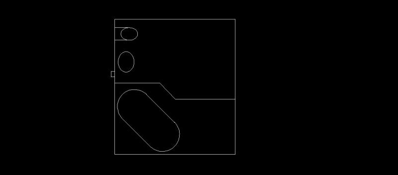

Anyhow, here is a quick diagram of the bathroom. The bath is on a small raised section (only a step high) and the small box on the left hand side of the drawing indicates where I would like the shaver socket to go. Not sure how the zones would be worked out though.
Need dimenstions, but if it is with 600mm from the edge of the bath then zone 2. If it can be splashed for any reason then you may need to reconsider its location.

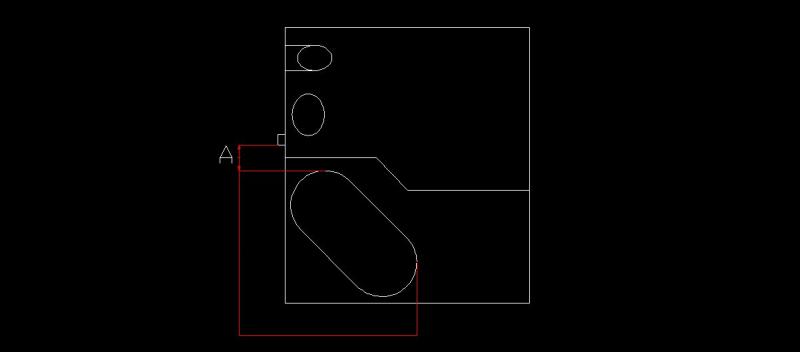

Does this image show how the room should be zoned correctly?
If so, are you saying that Dimension "A" should be greater that 600mm?
I have never noticed any kind of splashing here and should find that this would be difficult - if not impossible. But I suppose this is the for ANY location in the bathroom - even accross the other side of the room.
