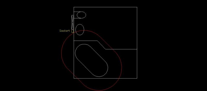

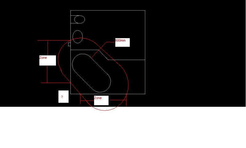

Just back on topic again, can someone look back at my past post with diagram in regard to the zones - have I drawn them correctly?
I would draw a line around the bathtub on your plan 600mm from the edge of the bath, and then project the points where that line intersects the walls on the plan onto the elevation of the walls to define the edge of the zone.
Then re-visit the the intentions behind the definition of the zone. In this case, putting accessories at least 600mm from the edge of the bath is intended to keep them out of reach of anyone in the bath.
In this case, the bottom left corner of the room as drawn might fall outside the zone, but the only way to reach that corner is apparently to stand in the bath, which is what the regs are trying to stop us doing.
Ok, this also seems reasonable.
Yes, practically the corner you specify can ONLY be reached IF you stand in the bath then lean over. There are actually taps in the way here on the side of the bath making this almost imposable, and if you do you would find if difficult to stand again.
The way you have drawn the perimeter, the small box on the left hand wall lies within this section. Whilst I appreciate this might not be exactly to scale, it is actually quite close and shows that the intended position of the shaver socket MIGHT need to be rethought.
