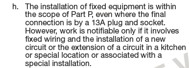

When part P was introduced, electrical installations in gardens were notifiable. Several manufacturers created dubious products for garden lighting/power which plugged in, and the manufacturers of such things claimed that by being connected via a plug, it somehow removed them from being notifiable. They were wrong.

As I also said, the work might well be notifiable in Wales but, if it were relevant to you, you would have to find someone else to tell you whether you could wriggle out of that by connecting the new ('outdoor') sockets via a plug/ socket. I very much doubt it, because the version of 'Approved Document P' (not 'law', but government issued guidance about the law) which is still current in Wales (although it has been superseded in England) says:
... and a 'special installation' is is defined in ..

The guidance in the approved document ( https://gov.wales/sites/default/fil...lations-guidance-part-p-electrical-safety.pdf ) says "Detached garages and sheds are not special locations. Work within them is notifiable only if it involves new outdoor wiring" but that's only "guidance" not part of the law itself.
On the other hand work on "Prefabricated equipment sets and associated flexible leads with integral plug and socket connections" was exempted from notification as long as it was "not in a special location,". The question then becomes how far "prefabricated" can be stretched, I think something made on site from arbitrary components is definitely not "prefabricated". The kits flameport mentioned with the socket pre-attatched but where you wired the plug yourself seem to be stretching the limits of the definition.
