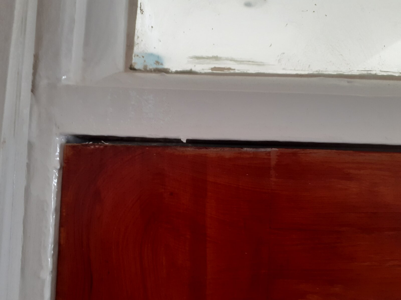

Shifting door hinges up 3 mm

Move the staple (keep) in the frame.
Consider buying some screws that fit the hinge.
When you do that, look at the screw holes for fit.

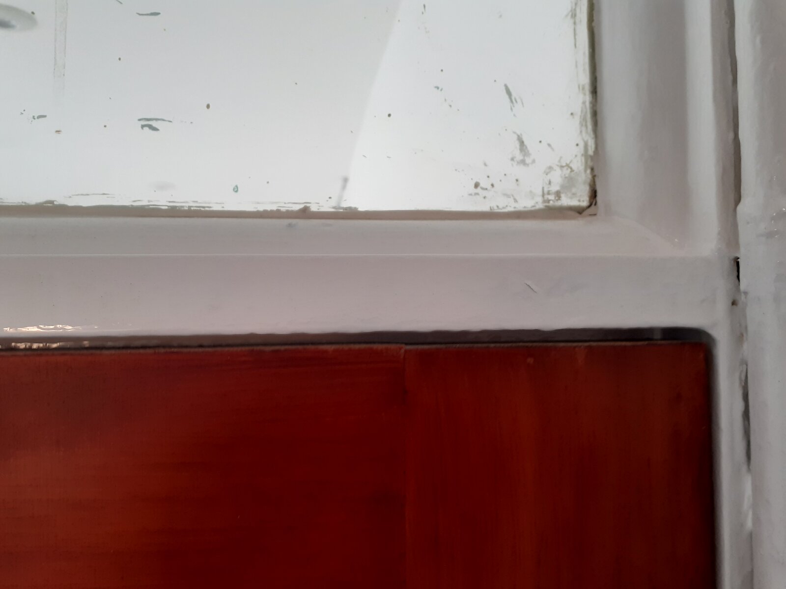

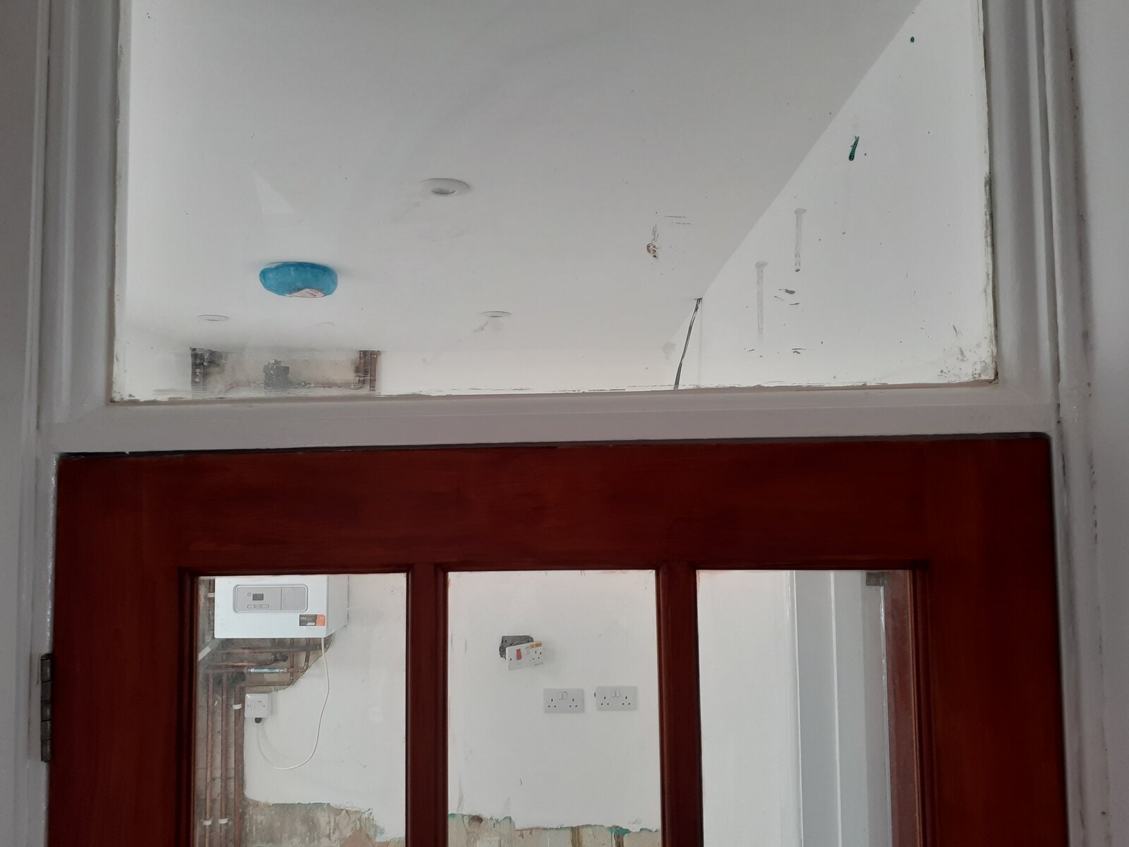

The door itself may have sagged, so photograph it from the other side, closed, so we can see if the top of the door is still in line with the top of the frame, and the bottom, with the floor.
Took door off to paint architrave. Screws with smaller heads?
I'll photo the top tomorrow
I've never seen doors drop on their hinges.
I'm not even sure it's a thing.
It looks to me like the door has had 2" cut off the bottom.
NO your getting it wrong, the whole house has subsided and moved a little and the door has stayed in the same place.
Jack the back of the house up and that will re align the door.
