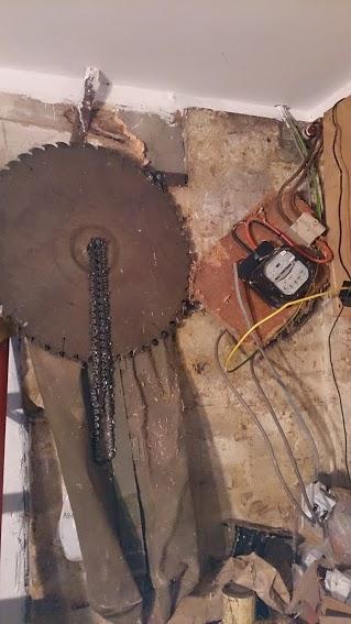

shocking earth
I've disconnected the workshop and just connected the flat to the double pole rcd (really old),
That probably isn't an RCD.
supplier (seaboard) want to put new meter in but wouldn't touch it with earthing in currant state,
If the supplier is refusing to install a meter / connect the supply, it's because the installation is dangerous and must not be used.
In connecting that to the supply you have put yourself and others in danger. People could be killed as a result.
i'll do that tomorrow, thanks, it has a test button on it if that helps
this is only pic i have taken after all junk cleared,
well it's around somewhere

rcd/ earth leakage is bottom right of this picture
Oh Dear!
We also need a picture of the CU and the earth rod which will be interesting!
Could you please take the time to upload it and display in your posts, rather than leave for us to find on your profile page, you have been given the instruction how to do this!

Did the "old junk" you removed included a fuse between the incoming supply and the meter ?
You have a supply coming through the wall as two singles and connected to a white box.
Where do those wires through the wall come from ? Do they come straight in from outside, perhaps an over head supply that is now without any cut out or fuse in the circuit between pole and meter ?
Does the RCU you refered to have two earth terminals ?. One marked E and one marked F If it does then you need the DNO to come and make the install safe, they will probably disconnect but you deserve that for what you appear to have done.
