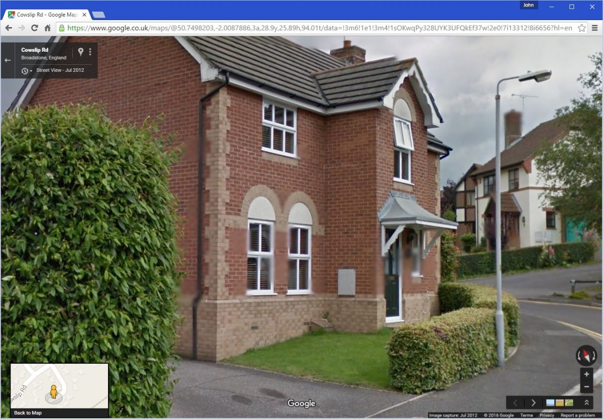

External electricity boxes? I can't recall ever seeing one. I have seen many gas meter boxes which look ugly and the doors fall off and look even uglier. I would avoid gas meter boxes like the plague as they make a building look downmarket.
They are a standard item on virtually every house built in the last 30 years.
Electricity in the white one, gas in the brown one on the ground.
I see. A Bryant house as well. That electricity meter box is "in" the wall. On existing old properties I don't think I have seen one bolted to the wall, like those ugly awful gas meter boxes
Bolted-on meter boxes are available to retro-fit on existing properties.
