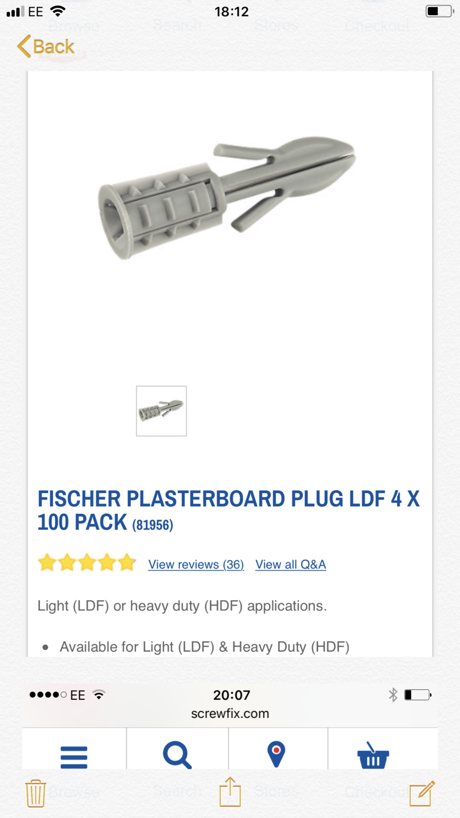

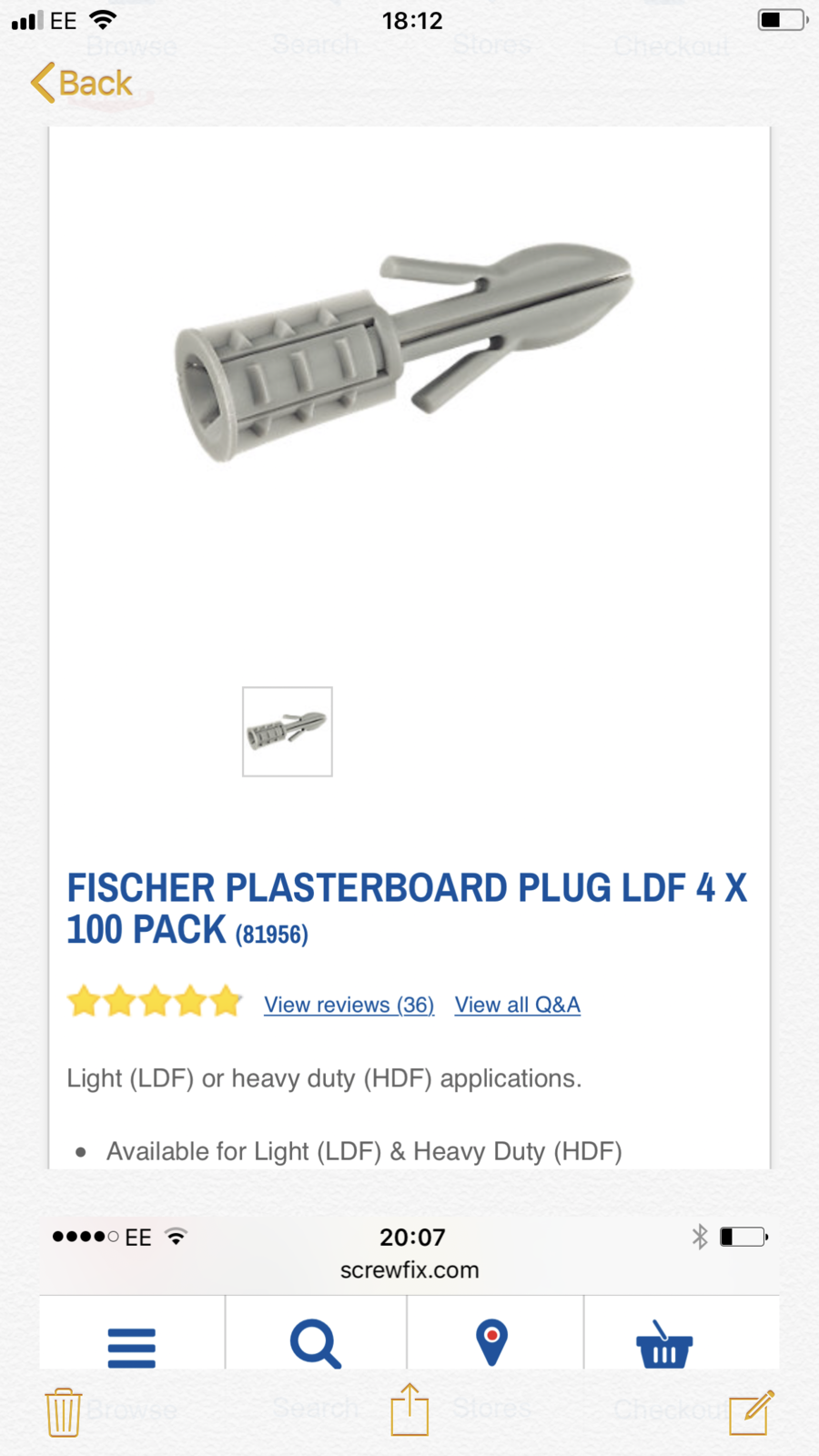

So I have used the plug in the above picture on plasterboard and used a 4mm diameter screw, as recommended, which is 30mm in length.
I have used this plug and screw to attach a plastic carrier bag holder to the wall.
However, I have had to leave some of the screw unscrewed from the plug so that the carrier bag holder has something to hook onto.
The problem is that the plug seems loose in the wall. Now I am starting to think it’s because I did not use a long enough screw especially as I did not screw it all the way in.
What’s your thoughts on this? Would a longer screw solve the issue? Thanks

The screws to be tight up for the plug to expand in the hole.

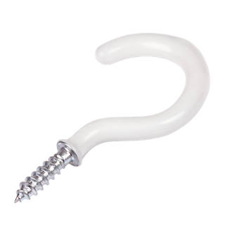

The problem you've got, is that yes, the screw needs to be longer than the plug, or it won't grip behind the plasterboard. The cup hook won't work in the plasterboard plug, and you'd be better off finding a hook that you can screw into the plug with a longer screw.
Sorry what?
Plugs like that are designed to mechanically fix against the back of the plasterboard in the void, not expand within the diameter of the hole so the screw has to be completely bottomed out (screw provided will be the right length to bottom the plug out).
Not like masonry wall plugs that expand outwards to achieve a friction fix.
If the screw isn't long enough or the screw isn't pinched up, the plug won't work and you should look at other types.
These fixings lock themselves without the screw needing to be inserted.
The cup hook will work providing you find one which has a long enough screw.........

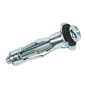

Grip Its are extremely expensive - on shop fits I use "umbrellas" (or more properly Rawlplug Intersets, but Fischer and Spit also do them), like these:

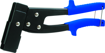

Which ideally should be inserted using a setting tool:
If you are doing any volume of fixings into PB these outperform Grip Its at a fraction of the price per unit. I doubt you'll find many tradesmen using Grip Its. Not too keen on Redi Drivas like the ones foxhole proffers - seen them go wrong far too often

you can get vine eyes and screw hooks in gardening places and on ebay, with a longer shaft, which would be fine for your bag holder.
