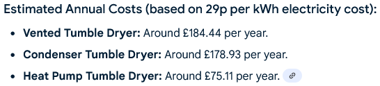

i worked out some years ago washing a full load on 60 degrees cold fill 1600 spin and full tumble dry worked out at 35p /2.5 [14p then]units total with around 1.8 units for the tumble so the maximum saved could only ever be less than 40p now using overnight cheap rate ??
If I look at any electric appliance, used once, less than £1, but we use stuff every day, so the cost per year is more important. So the important time is 4 pm to 7 pm, as the cost is 36.06p per kWh so don't want to run out of battery before 7 pm, and at moment 5:30 pm I start battery discharge, and the difference between 25.76p and 15.45p is not that much, so yes once I change to Octopus, the running overnight not quite so important.
But with British gas, 8.95p to 31.31p, the difference is double. So it would depend on the tariff. It seems peak - off-peak can vary between 10 and 20p per kWh. So taking average from the internet
cost difference between a 1/3 and 2/3, so heat pump £25 to £50 a year saving, and the others £60 to £90 per year. Not sure how accurate the data is? As I found, the vented tumble dryer had 1 kW or 2 kW option where the non heat pump condenser dryer does not have the option to run on low heat, so due to low heat option the vented was cheaper to run compared with non heat pump condenser dryer.
The figures are likely repeated with dishwasher, and washing machine, so times 3 so £75 to £270 per year. Depending on tariffs and types, but the idea of scare tactics without saying what make or type of dryer, does not make sense, we run our freezer overnight, and that is the same technology as the dryer.
the tumble at £184x29p works out at 1 tumble a day at around 1.75kw
as an aside a load at a 1400 spin speed will need 2-3 times the energy to dry over 1600 spin speed as 1600 comes out damp to dry to the touch rather wet to damp
600 watt x 2.5 hours = 1.5 kWh with a heat pump drier. However, sometimes it uses a mark/space ratio, so not as simple as time x power as power can vary.
