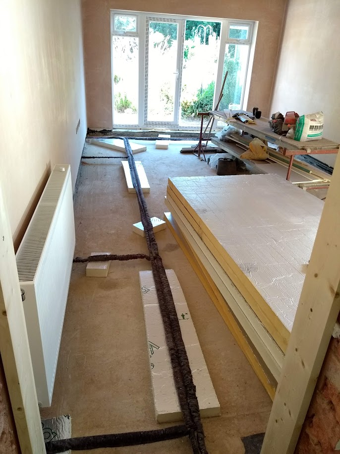

Radiators in too.

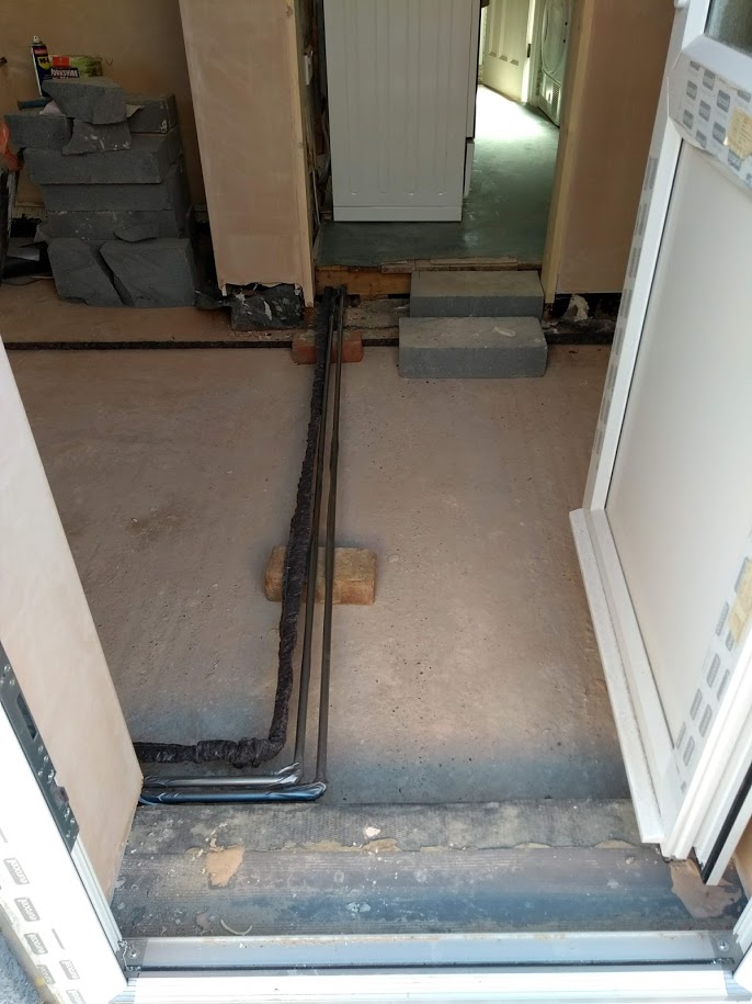

All looks good to me. Pipes taped up - insulation will be under, screed on top. Is denso tape or lagging enough protection against screed?

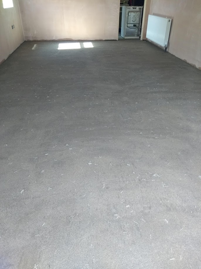

well, they had some additional tape over them all, floor is screeded now.
Too late now, I suppose, but as Celotex is an excellent insulator it would be better to seperate the hot pipes from the cold mains by a few inches, and insulate them individually to reduce heat bridging (making the cold mains warmer).

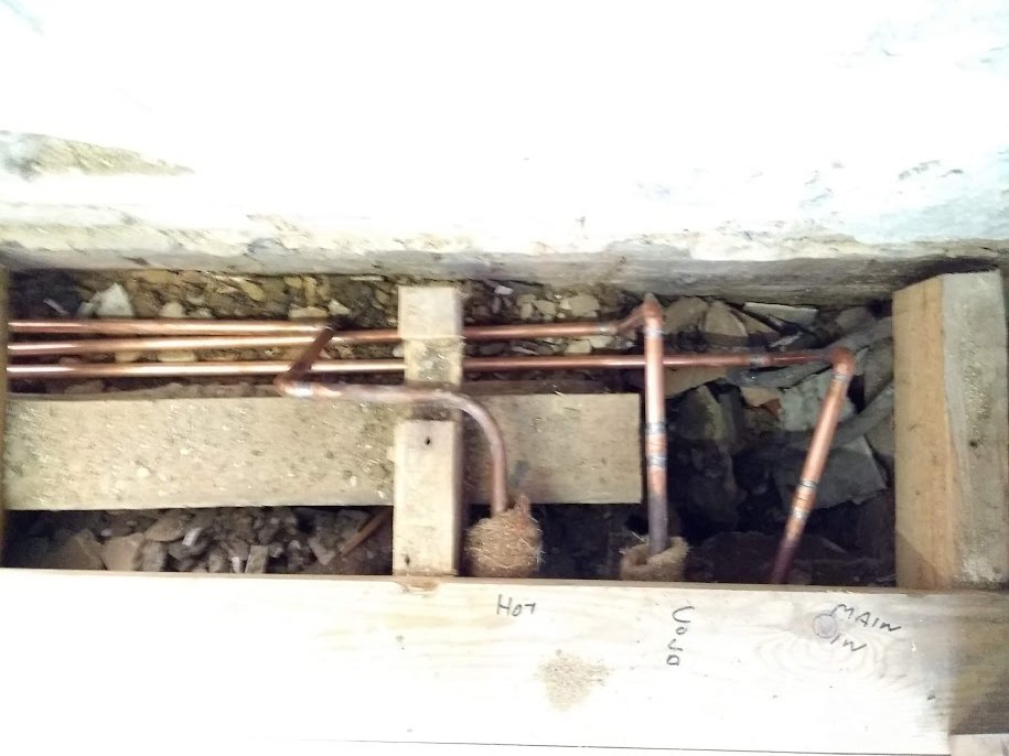

I also noticed that the three pipes are labelled 'hot', 'cold', and 'mains'. Typically the kitchen sink would have cold water directly off the mains (wholesome water for drinking). To comply with water regulations one cold tap must be fed with wholesome water, usually nearest the kettle! If this has not been supplied then it looks like it's an easy and quick job to change it by virtue of those pesky plastic fittings. I'm not a fan of plastic pipe/fittings, but they have their uses, and apart from the aesthetics they work well and last a long time...it's not so long ago that plastic loft tanks were being slated by those who favoured the tried and tested asbestos tank.

MM, it was all changed to soldered copper and mains was kept away from the others. The main goes straight to kitchen sink, via the meter that's under the sink.
Apart from the protection from the screed not being, IMO, perfect, I am happy with it now. Had I known that plastic coated copper existed, I would have asked for this.
