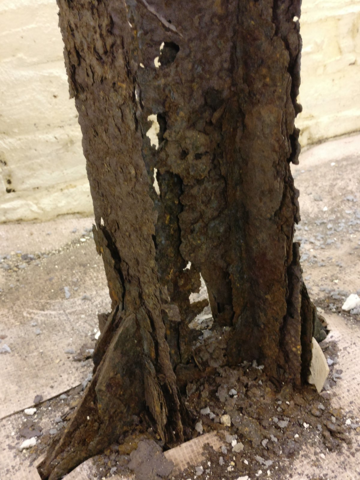

However the real issue is that the property has a side-conservatory with an under-room (like a cellar but not underground). We understand this was a conversion from a large greenhouse, with a rather old reinforced concrete floor supported by ancient steel girders. These girders are exposed and the survey report simply says in passing:
F4 Floors
The floor coverings in the property comprise of a mixture of suspended timber and
concrete. The floors were generally firm underfoot with concrete floors found towards the
rear of the main property. It is likely that timber repairs will be necessary during further
opening up investigations and damp treatment. The undersection of the side conservatory
extension was inspected and found to be relatively dry. The visible steel column has
corroded and should be maintained.

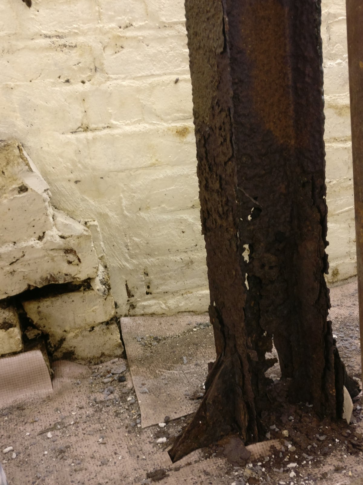

Here is a photo of the steel column, which is in no way visually obstructed:
Now this immediately concerned me and having shown several people they were worried too. I was leant an acroprop so there is no immediate danger, but a local structural engineer viewed it as a favour and was equally concerned.
If this was highlighted in the survey we would certainly have taken it into account with our offer or demanded it be fixed... closer inspection showed other girders were badly corroded though to a less dangerous extent, and the concrete floor has some crumbling and needs proper inspection. Likely, having this properly taken care of is a few £thousand - the engineer even suggested removing the concrete floor and replacing with a new wooden one might be cheaper than getting expert concrete restoration people.
Should I be contacting the surveyor about this? The survey only listed it as a medium level thing, unlike things like the roof which were highlighted as serious. This is not just a corroded steel, it has a hole all the way through the the I part is very severely rusted too... kick it and big pieces fall off.

As you have now said that it isn't particularly accessible, are you sure that it is the column that the surveyor reported on?
There's three in a row... If he noticed one was corroded and didn't look at the other yep that's not exactly thorough :)

Well, the column is corroded, and it seems sensible to advise some maintenance...
Well I can see 3 columns in that picture, I would say that a better desciption of the one in question, "was severly corroded, and should be replaced at the earliest opportunity".
On the other hand, if those are the visible ones, where are the invisible steel columns.
Exactly my point, yet he should have been more specific and warned the client that there was a fairly serious problem that was going to cost him money. Telling him that one has corroded, and needs to be maintaned doesn't quite describe the sitation properly - or am I missing something.
Would I be incorrect in saying that to "describe the situation properly" would be more in the realm of a full structural report, rather than a generalist one?
corroded ?seems a bit of an under statement to me
severe corrosion
Rotten ???????

to be fair that's std surveyor speak, never over or under state anything, he hasn't lied and it's not a full structural survey so not really his remit to assess the possible structural effects. I would very much doubt if that pier alone would affect the integrity of a reinforced slab above otherwise that would have come down by now.
