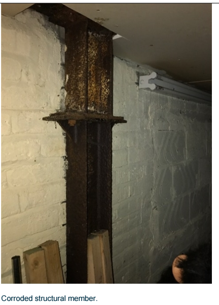

I was looking through the survey report and found in the appendix, the photo above. I think this is the one on the far right of this photo below, while the really bad one is on the left:
1504715600241782799390-jpg.126286
However :
  1. Even the right-hand one is pretty corroded at the base, which he didn't photo
  2. The base of this pillar is blocked by a single small piece of wood i.e. not at all
  3. The room is not full of crap blocking access to the pillars.
You can see I subsequently removed the plasterboard to inspect more fully but this didn't impact the visibility of the really rotten aspects.

Are you concerend that the surveyor wrote one sentance on the corroded column instead of two, or are you worried that the floor will fall down, or that you paid too much for the property based on his poor report?
I'm worried that they didn't pick up on something pretty obvious which is going to have a non-trivial cost to remedy at a structural level, beyond normal maintenance expected on an older property. Not just the very obvious exposed damage, but the likelihood this might mean the ceiling itself has similar damage - that I wasn't made aware of the former or advised to get a further survey of the latter.
However since I have no idea what might happen in such cases I don't know what I'm hoping for... to get some sort of refund, to claim on their PI, etc. My understanding is that the point of a survey is not just to find problems, but to offer some protection if they miss obvious things in terms of a sort of insurance. Since my mortgage required a survey be performed, there's quite a lot resting on the report (as well as on the beam).
My query is whether to initially instigate their complaints process, or to write more informally advising them of my concern in case we can avoid this, which I assume they would rather do?
That whole framework of columns and beams is severly corroded.
That corrosion is caused by very poor ventilation, and that recent floor insulation has not helped, but made things worse.
The point is that the surveyor should not be just saying that the column has some corrosion, but he should be telling you why. So it is not that you just need to paint on a bit of hammerite, but need to deal with the underlying cause.
The work you will need to do is replace the column, and possibly any other steelwork too. If you are happy to do that, and can sudenly find a few thousand pounds then just do it.
If however, you feel that this unknown cost puts you at a loss, and the advice you got led to this loss, then that might be something to complain about.
But TBH, you really dont seem to know what you want. So just moving on, paying for a structural engineer's report, getting some design calculations drawn up, submitting a building regulations application and fee, getting builders in to replace the whole lot and then making everything good, might be a better option.

Well, we were under the impression it was an old but fundamentally sound structure (we think the steels and concrete floor must be getting on for a century old). We were aware from the survey that e.g. the roof was original and may need major work/replacement, and that the windows were original too - so we factored those likely costs into our offer for the place.
Had we been aware this floor/supports was unsound and needed urgent remedial work, our offer would have been revised - simple as that. I would not expect a surveyor to pull the ceiling down to inspect the concrete floor and hidden steels but I would have expected him to advise it BE inspected - the moment I realised the uprights were so damaged that is exactly what I did which seems common sense to me.
As it is, I was able to get a structural engineer through a mate to take a look for free. He said only that one upright needs replacing immediately, but the others will do and also the cross-pieces concerned him - as well as the unknown state of the concrete floor which had crumbled in one place exposing rusty iron work (danger of spalling). His suggestion was that removing the whole floor and ironwork and replacing with a wooden floor would be easier than getting experts in to inspect and repair an ageing, dubious structure. Which is a big job and most inconvenient as the room above would be out of commission too!
