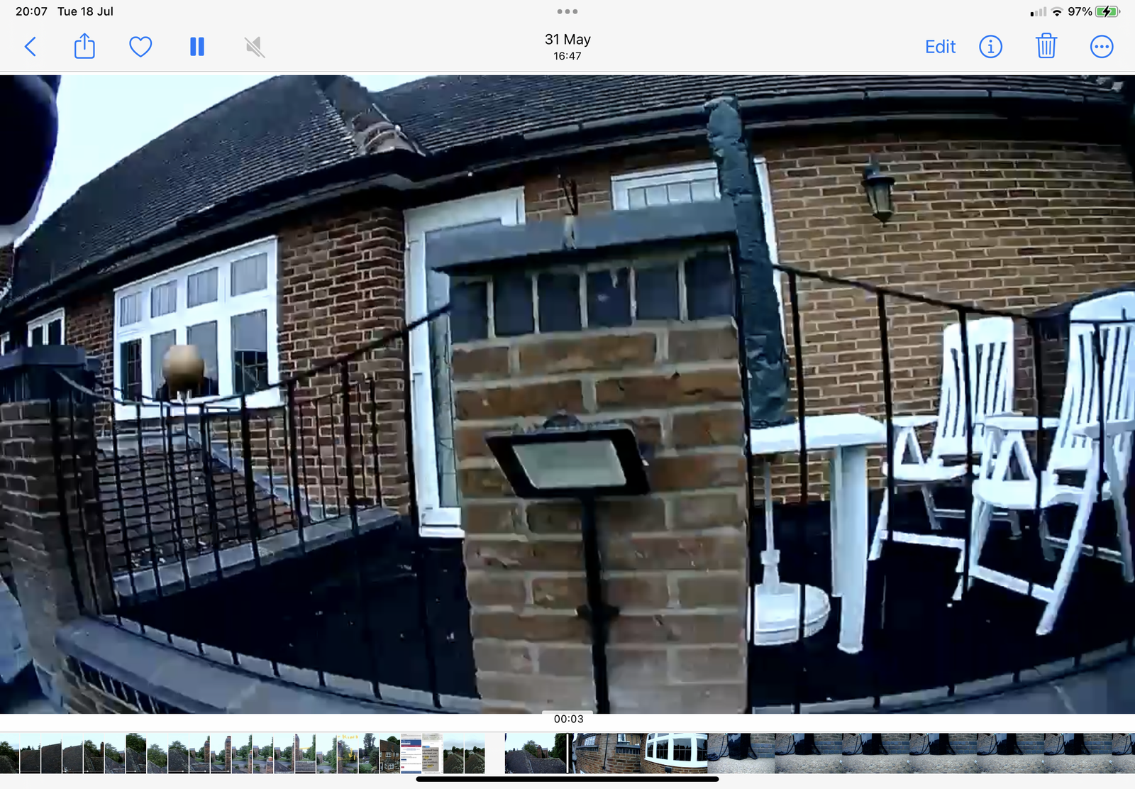

It was built as a proper balcony,The balcony has wooden joists and is on top of a garage. It then has plywood. Then it has a rubber membrane sheet thing, then thick black rubber tiles which i think were called eurotiles

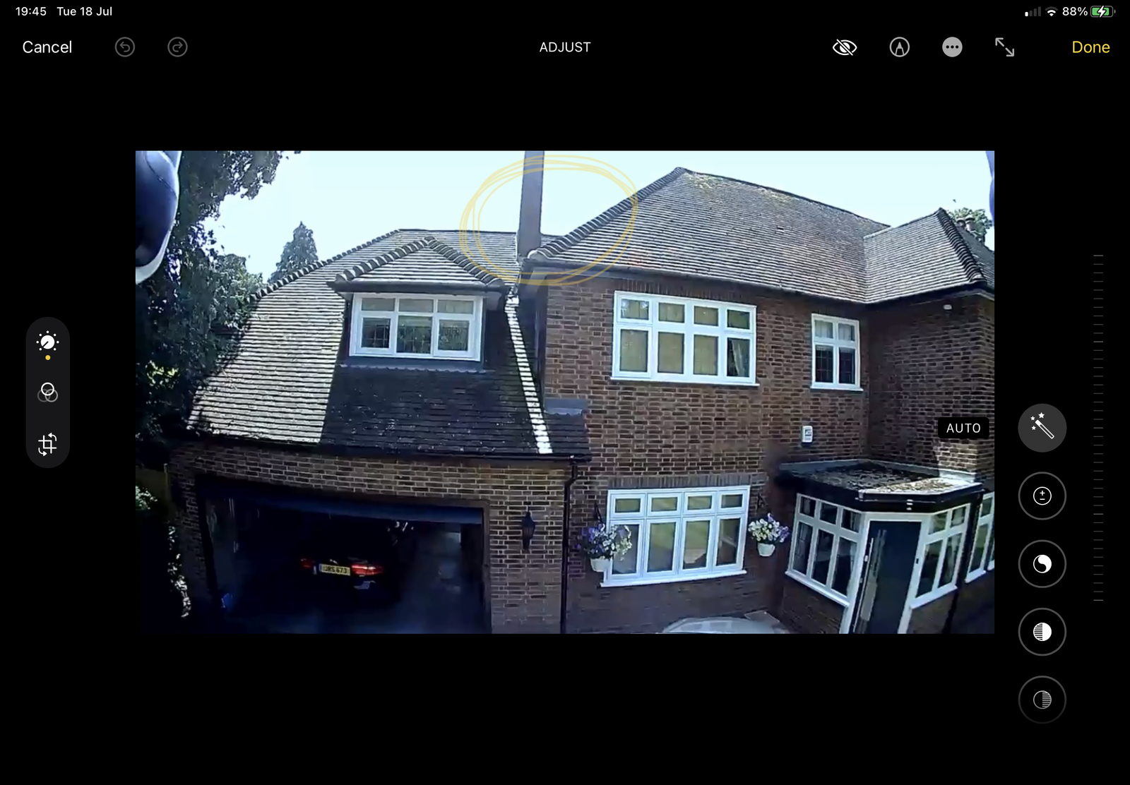

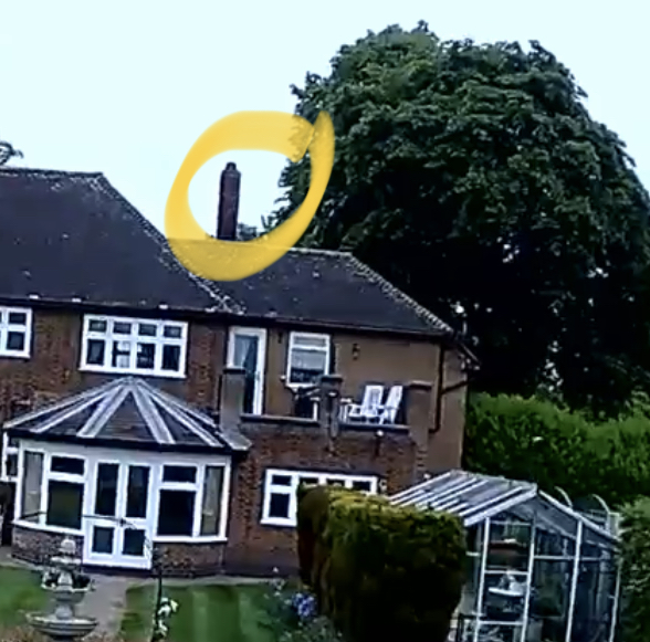

This is it from a distance from the front amd back. The chimney is hard to get to. It has got bar things holding it up though. Heres front and back
Heres it a bit closer up. Someone just mentioned….do you think he might be worried about the weight? And also, unrelated, shouldnt the scaffold people come round and look before the day? I am too scared to ask the roofer now! Wish i hadnt paid a deposit,but he never mentioned this.
it doesn't need to come off the balcony. its the esiest way i guess.
Ask about use of beams. as you rather not have it on the balcony.. if they say it can not be done. Get another
Tower up the front and send beams back from that. They would sit on the ridge, and any work platform could come up off of that .
A good scaffolder could do it easy enough.
You may get the odd damaged tile when it comes down, but tie that in with the roofer
