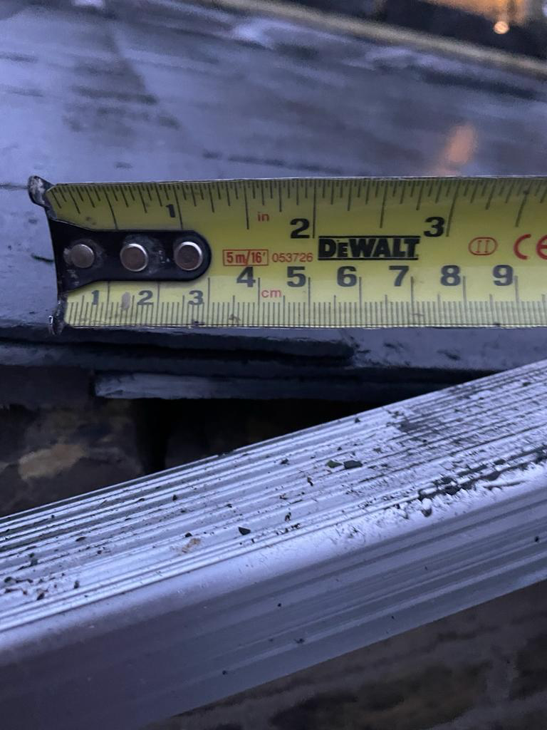

It’s my first time doing a roof and I don’t want to touch it for 30 years
Does it need redoing or is it acceptable
The previous slate roof was also lapped like this apparently so I don’t know if I’m being awkward or this is going to fly off with wind
Well I have never done a slate roof where the slates are not on the batten, I don't know the consequences. Should have used slate and a half on the verge.

1) So on the verge there are two tiles not one and a half. I don’t think that’s terrible?
2) soakers were used on every tile against the wall
3) there was no building regs as this is like for like replacement.
They worked real hard and I don’t want to be a trouble maker. They started at 7 and haven’t stopped and will be back tomorrow for a full day so it seems foolish they did not put it on the batten
Do you think they will blow up in strong gusty winds in London and therefore need redoing ?

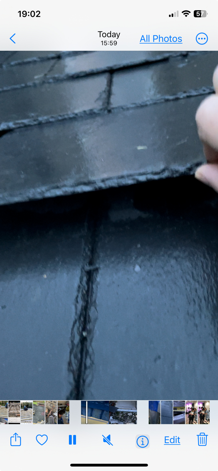

Have these boys done roofing before? I'm not a roofer, however I'm pretty certain the slates are supposed to be secured with slate hooks to avoid issues lifting with wind and/or correctly nailed. And I've never seen the technique of aligning the top of the slates off the batten, although others on here will advise if that's acceptable.

All tiles are nailed with 30 mm copper nails and there is some lift in the tiles when I lift them by hand
The question is whether the tiles will lift with wind.

Judging by your video, I'd say it's possible if not probable. It didn't seem to be taking you much effort to lift them, so imagine the force of high winds. Which is why I'd have thought clips would have been a good idea.
Thank you - What can be done now to make it better? Apart from the roof coming off and being relaid....

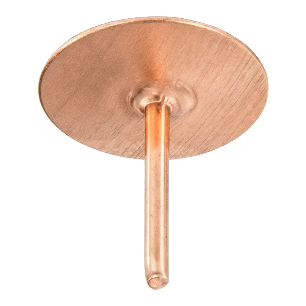

Are some copper rivets a good idea at this stage in between the tile laps?
Copper disc are for imitation slate which are pre holed.
Your roof has been done wrong
Remove all and regauge battens
