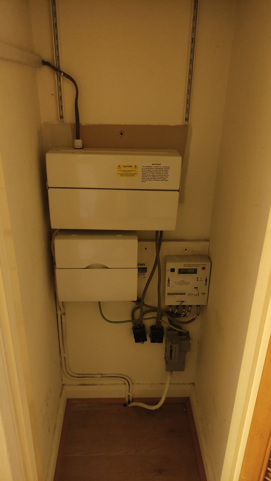

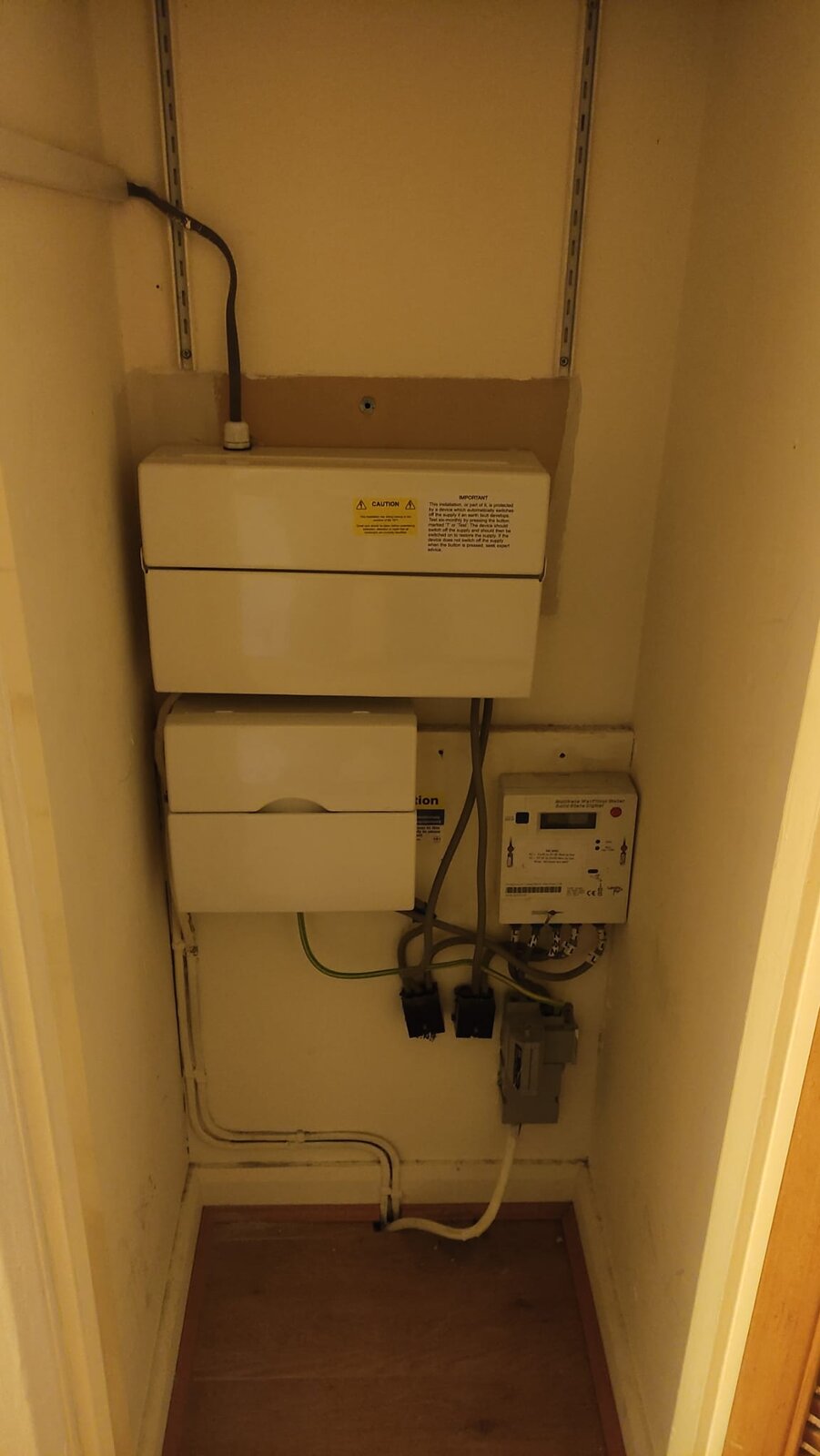

Resurrection for update.
I shopped around, had a few quotes from close-by Edinburgh and Leith companies. Most ranging between £1200 and £1500.
Then i discovered an old guy on Facebook. He had moved the the Borders (where i live) with plans to retire but his wife has been promoting him on every local group in the Borders and he is busier than he has ever been.
Anyway, work done for £400.
Did he forget his spirit level ?
And I’d like to see the tails entry points too?
Can you post a photo showing the circuit breakers?
And what paperwork were you given?
