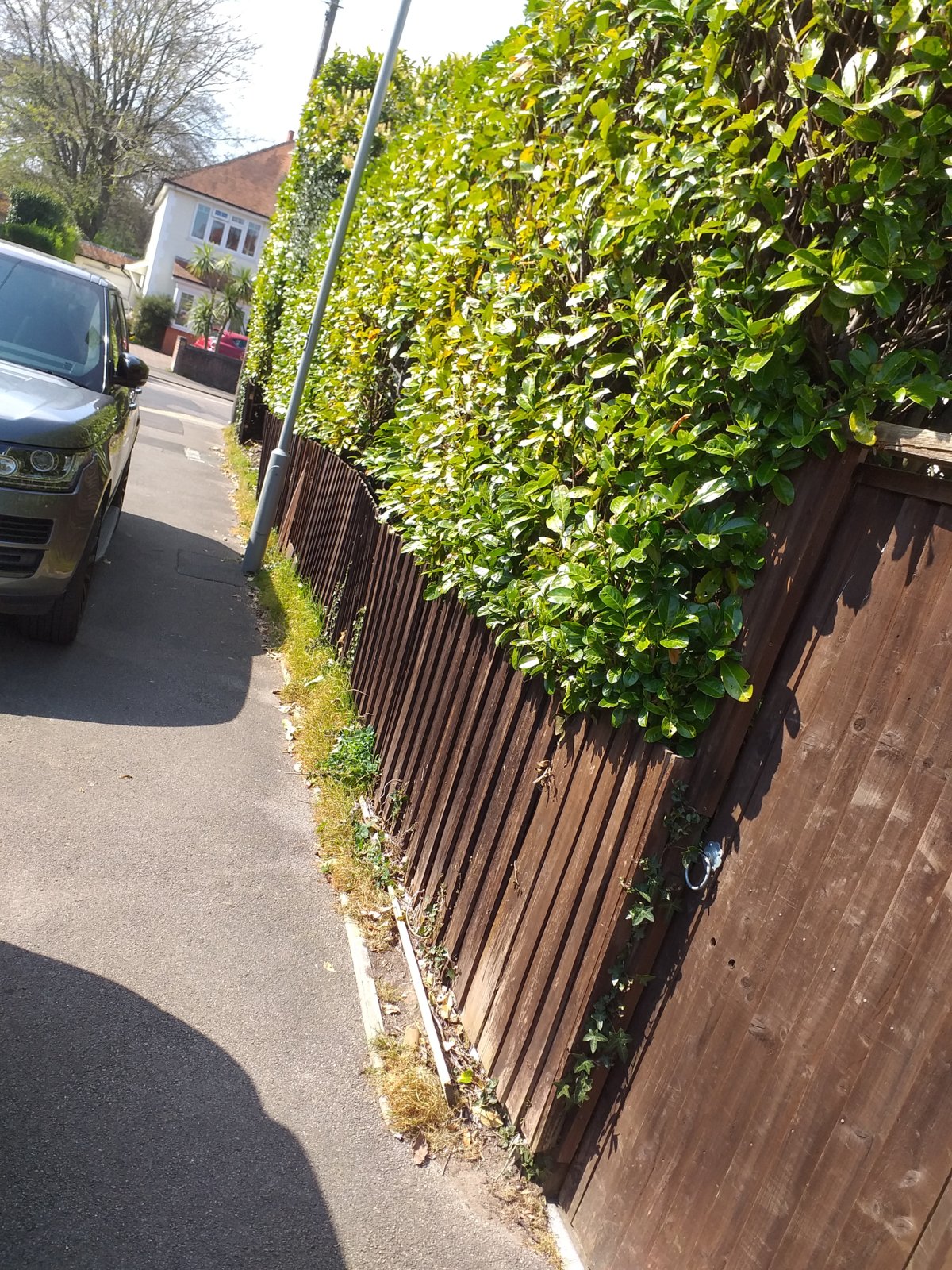

Should this fence butt right up to the pavement?
When councils renew pavements they lift the lot and take whatever land you let them.
That's why many landlords keep growing their hedges further into the pavement.

Ok. She was mentioning paving so maybe she was thinking what you're thinking . So what would be easiest thing ? Paving slabs?
This is the old fence (its tied up to stop it falling) but pretty sure it's in a similar position to mine
Either paving slabs or paving blocks.
Red would make it clear that the land doesn't belong to the council.
Secure them at same level as pavement or slightly higher.
Better if bedded in sharp mortar.
Ok I'll suggest digging it out then putting in mortar and red block paving one high next to edging stones. But if you look at photos of old fence in my post above yours the fence is mostly in the same position
Exactly!
Looks like they had moved the fence back and when the council renewed the pavement they nicked their land.
Exactly!
Is it easy to do? I mean do i just dig a small trench next to pavement edging stone then chuck in mortar used to build brick walls (e.g. 5 to 1 and wet) on soil then put in blockpaving using a spirit level? I wont point between the bricks/blocks as it might look rubbish. I'll butt them up. The hidden cement in soil should hold it. The gardener can then strim between blocks and fence.
I'll call the lady and suggest it saying it's not because I put the fence in the wrong position ( I have the photos of old fence which I followed and theres a lamppost) but that I want to protect her from the council digging up path and that the previous guy who did the old fence should have done this and I'm shocked he didn't. I'll sort the problem out for her.

Use a semi dry mix 6 sharp sand i cement,and tap into place using rubber mallet, butt them up and brush in block paving sand,colourwise i would use charcoal to match pavement.
It will also cut down on future maintenance.
As above, but i would use red blocks to make it clear that's private land.
When you dig, try not to disturb the soil so you have a solid base.

I would just add something to stop weeds/grass growing as between trimming it will look horrible. Either brick/slab/or bark.
I'd say you were in the clear about the position because of the old fence line. But you could have moved towards the fence if asked to. Quite possibly there was concrete from an old fence or wall and the previous fencer took the easier option?
