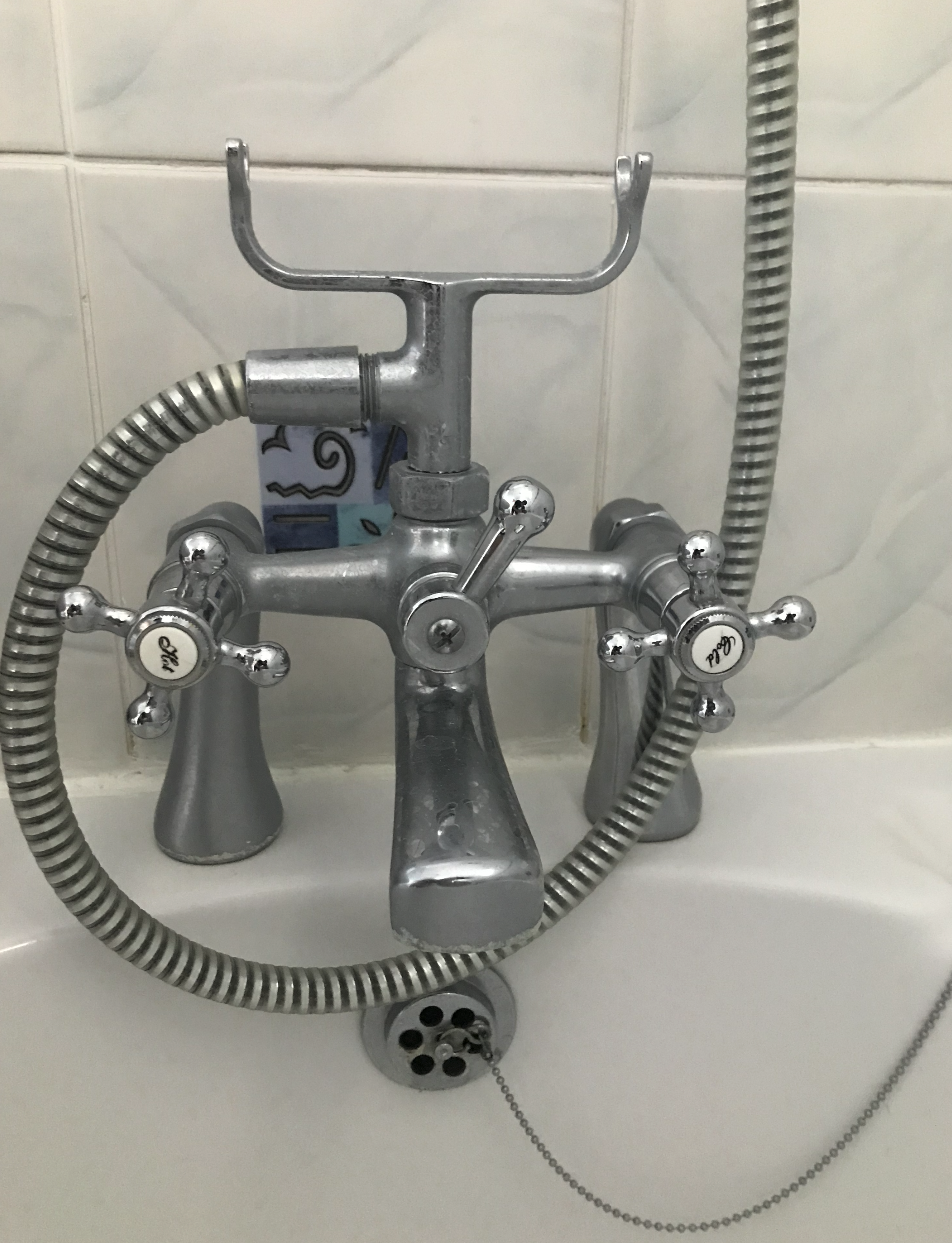

Earlier in the summer started noticing sporadic hot/cold intermittent supply. Hot supply for a couple of minutes and then endless hot/cold alternates, the cold cycle seems to last around 10 seconds, with the hot cycle a bit more. This is not an everyday occurrence, although it seems to happen more in times when the shower is used more often (say for example, the mrs uses the shower and I jump in straight after - I'll get the hot/cold cycle!)
Boiler is a brand new Worcester 30i combi installed last October (which we had installed immediately after moving in, so I don't have much of a previous comparison). Bosch was happy to send an engineer around who run a whole lot of tests and concluded that the boiler was fine. He mentioned our hot water temperature setting was set maybe too low (it was set to 48c) and that the boiler could potentially be reaching that temperature very easily, which could cause the hot/cold cycle. He jacked the temperature up to 60c.
He also said the issue could be with the shower itself, but he offered no further details on this.
It had been a few weeks since we last noticed the issue, so I thought he had been spot on about the boiler temp - but this weekend it started happening again!
Shower/tap picture attached - what could be causing this?

Could well be that. It's recommended to have thermostatic mixers with combi boilers to overcome temperature fluctuations

Hi Andrew, thanks for the input.
We plan on renovating the bathroom in the following year, but until then, I'd like to understand what could potentially be happening here? I am completely clueless when it comes to plumbing, but how could these fittings impact the temperature? I have always felt it was very hard for me to get the temperature I want out of the shower (I am constantly fiddling with the cold tap to get it "just right"), but where could things be going wrong when it comes to the temperature fluctuation? And how did this only start happening recently?

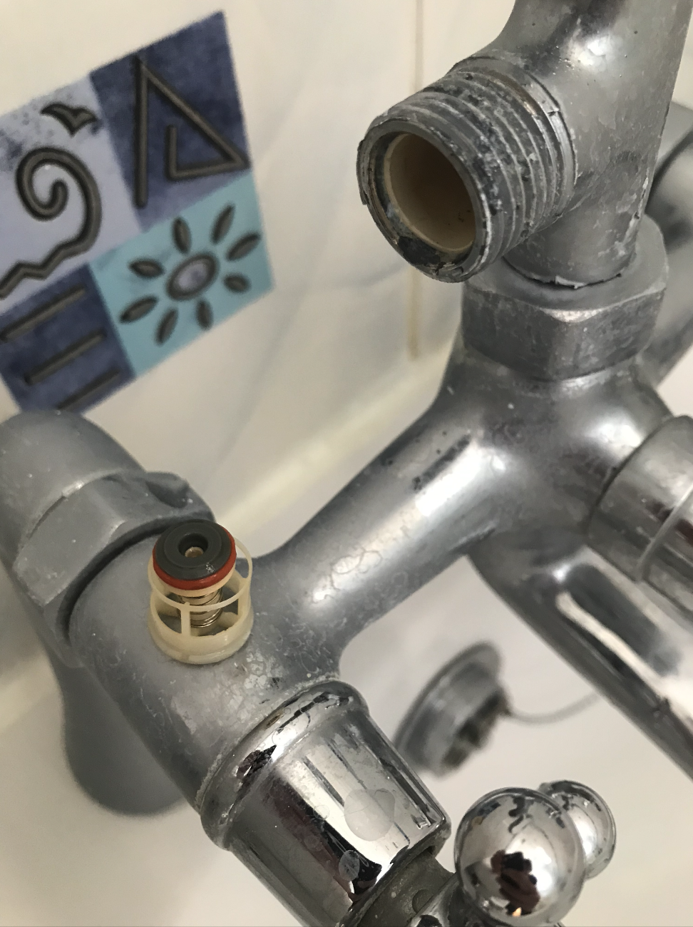

This is what I found in terms of flow limiter within my own system (attached picture), would it hurt me trying a few other limiters? I suppose that in my case, I'd be looking into increasing? The current one seems fairly standard in shape to others I find online, although there is a spring like attachment which I am not soo sure about...

Try taking the shower head off and running the water through the hose only. See if the temperature becomes more stable.
You could also try running the basin hot tap at the same time as the shower. Just to see if it helps.
Thanks, will give it a go next time it happens, which seems to be quite random at times! Went through a couple of weeks without the issue!
