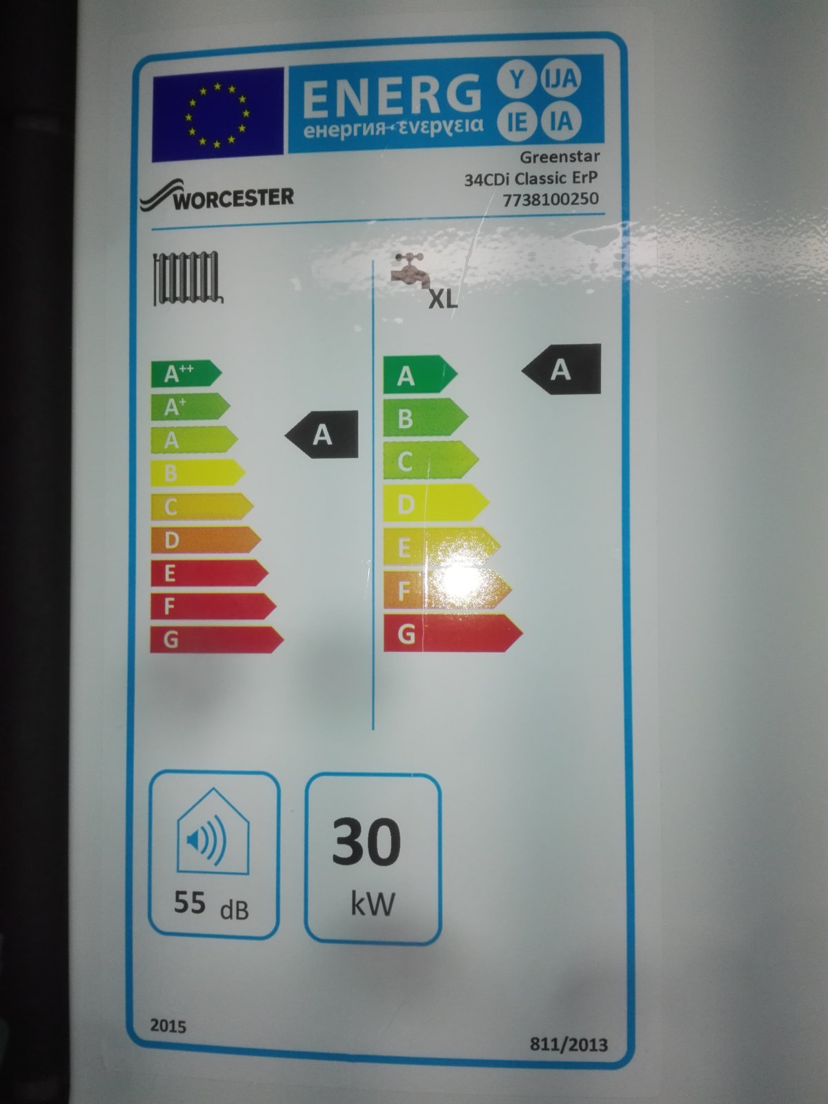

My boiler is a 1 year old WB Greenstar 34CDi Classic.
I have been considering the Mira Magni-flo ERD range as they claim to improve the flow rate.
My dilemma is that replacing the 1/2" copper into the house with 25mm MDPE will be quite costly (I am beyond the point of being able to do my own groundworks) and I need to be sure before going ahead with it that it will give an improvement. Having said that, the pipework in the house (at least on the cold side) is all 1/2" or 15mm, so will changing the incoming feed to 25mm make that much difference?
