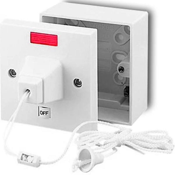

If you have one of these
Did you think to turn that off too?
Reason I ask is a colleage went out on a job yesterday as the customer came home from their 3 week holiday to find water running in the shower. Their solution was to pull the cord and call electrician out. He arrived, pulled cord and water started running so reached in to turn the shower heaters knob to off but it was already off and turning through all positions only lit the high power light. Pulling the cord stopped water again. Luckily the water all went down the drain and not spill over the open cubicle.
By chance they had read their gas, electric and water meters a month before, water had gone up about 300m³ and electric about 3500KWh.
It seems the plastic switch moulding had broken.
I know we've had this discussion before but when will people remember to switch these things off when not in use? Isolators are there for a reason, not just for show.
