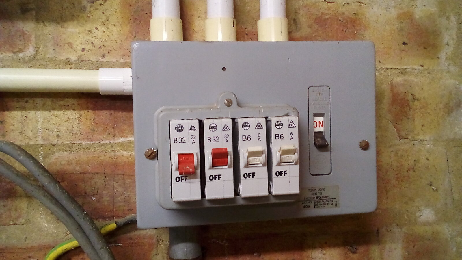

the cable shows signs of charring, so is damaged at least in places, most likely it is undersized for the load you want to put through it so needs replacing entirely.
So yes, new switch, new cable, new MCB (preferably RCBO) and new CU.
Because a CU is mostly just a metal box full of air, a big empty one is not much more expensive than a small empty one.

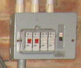

To my eye, the cables in fuses 4 and 1 also look suspiciously dark, so perhaps they have also overheated and need replacing. Once the copper wire has overheated, it softens, and will not make a reliable connection again, so will overheat and loosen and overheat even more.
