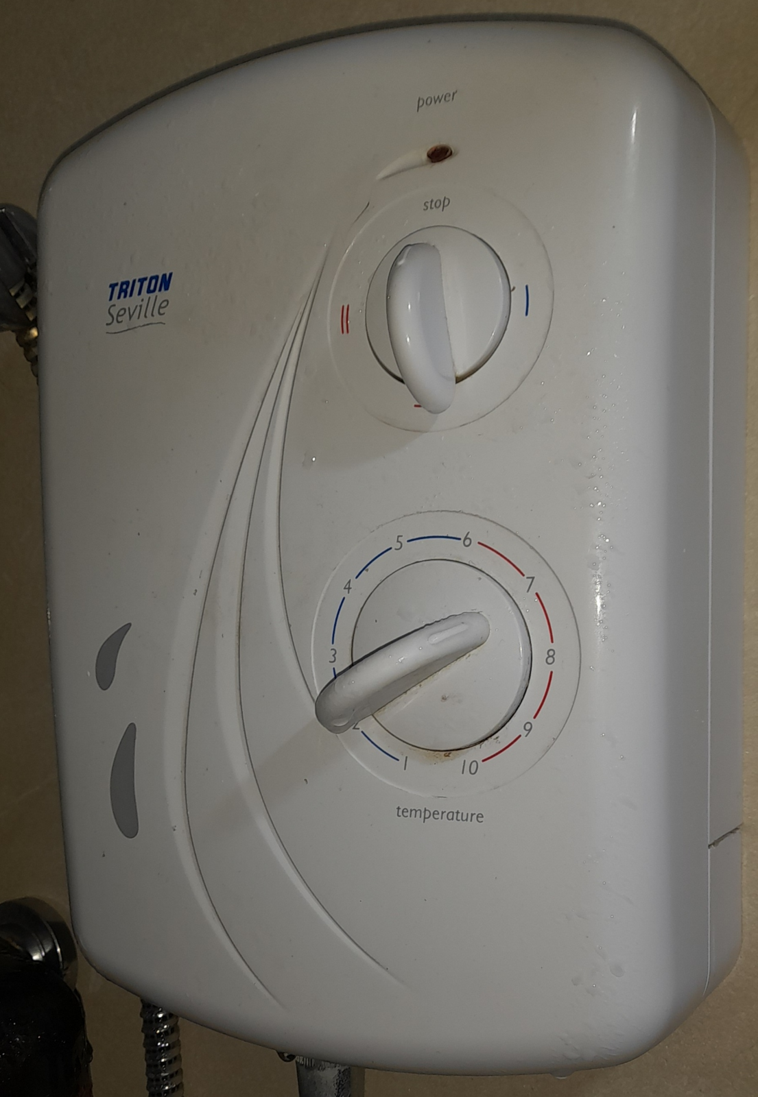

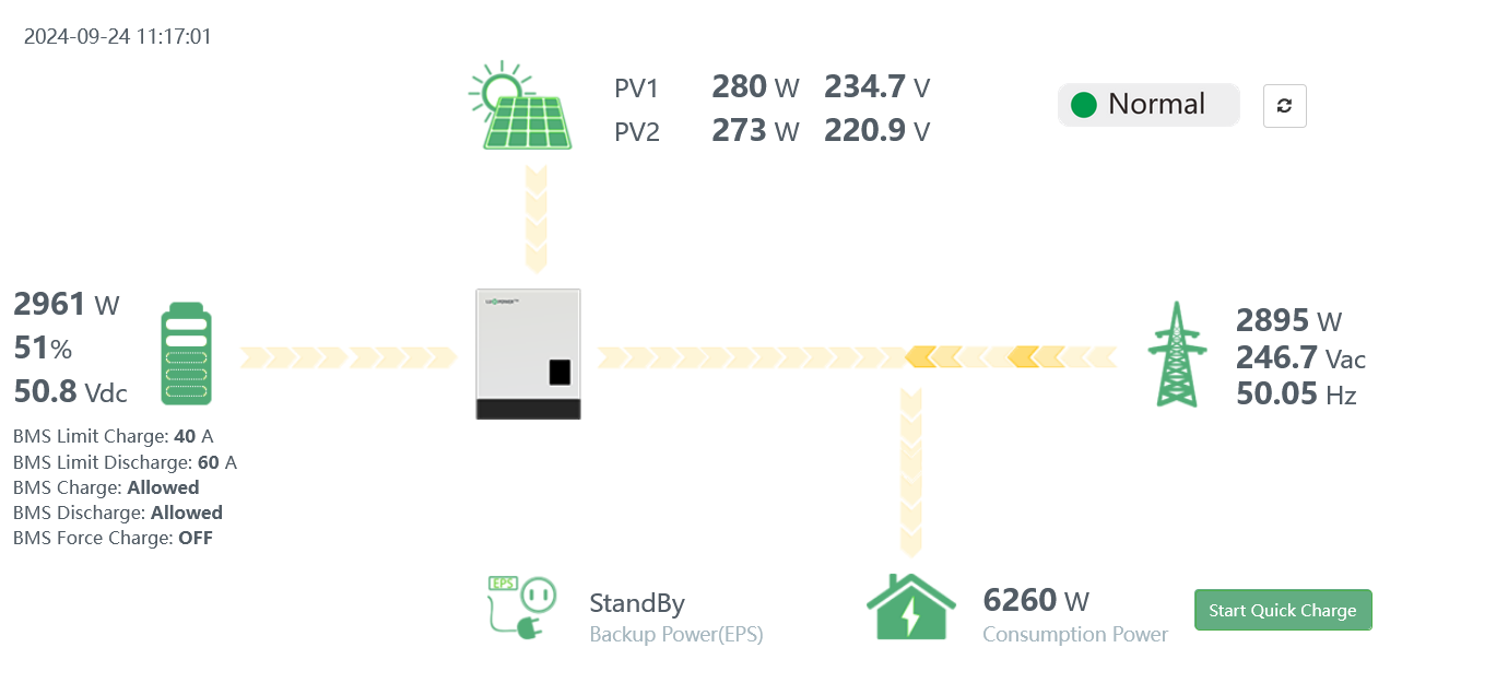

As title the shower shows importing off grid just over 3 kW on the IHD (in home display) and the solar software shows 1727173638313.png which seems to show the same, approx 3 kW import and 3 kW from battery, so using 6 kW, looked at the manual on line

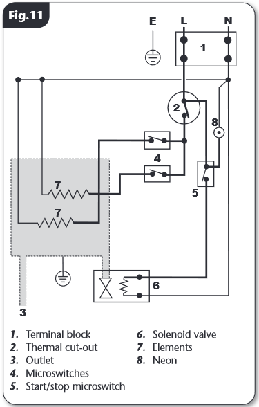

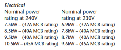

1727174381054.png and there is it seems a 7.5 kW model, but the shower seems quite good, not complaints about power, there are two settings not a clue which wife uses and the diagram seems to show two elements 1727175070969.png so may be she is using Eco setting, and I always use Eco setting, but for years I have said how useless electric showers are, last house came from an instant gas water heater a Main 7, and mothers house originally from the DHW supply with an electric motor to boost power, and then from a Bosch combi boiler, and to be frank due to the delayed start with the gas power, the electric is actually better.

at setting we use just 6 kW.
As suggested - An electric shower will only use what ever amount of electricity it needs to obtain the set temp that the user has it at. That draw will be governed primarily by the incoming water temp against the required set temp. The higher the cold water temp (anywhere up to 15deg in summer) then the less energy the shower needs to reach that set point, in your case it just needs 6kw. I'd check that draw in the winter when the incoming cold mains has dropped to < 5deg and ECO mode is no longer good enough.
You beat me to it! It's all down to the cold water temperature and basic physics. The ground is probably at its peak temperature now, having absorbed the sun's heat all summer. There isn't some giant conspiracy trying to sell needlessly overpowered showers to the masses!
We have two electric showers. One is an old fixed power one, 8.5kW. It's good in the summer, only just adequate in the winter. The other is 9.6kW but you set a fixed flow rate and it backs off its power as needed to maintain that flow. It's set so it's at 100% in the coldest of winter days and gives the same flow for less power now. It also provides handwash water, it's great all year round.

For a given kW rating they can't have improved. 6 kW is 6 kW, which seems pretty sparse. They were 8.5 kW years ago, nowadays there's 9.5 and 10.5 kW, and still borderline for a good shower! (though no doubt adequate)
