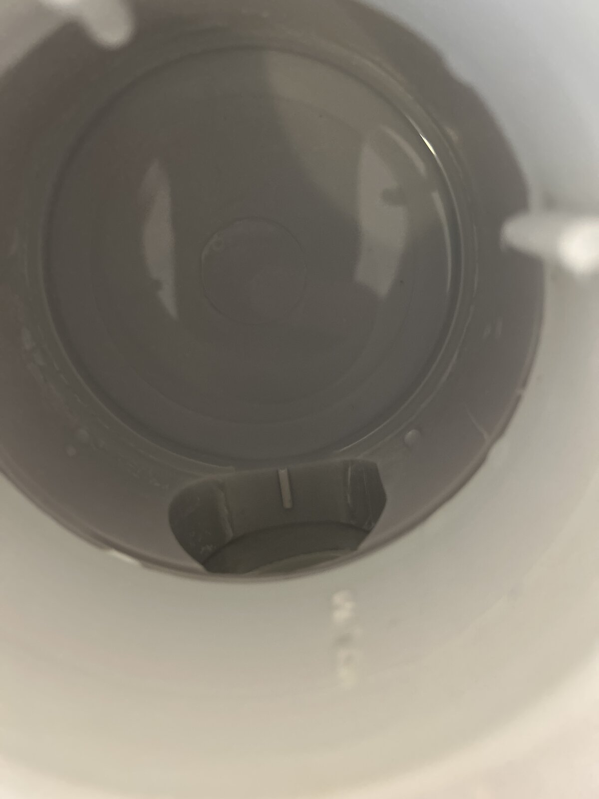

Hi All,
Our shower has a very strong smell coming from it, smells like weed to a point.
We have had hair build up previously but has cleared with cleaners.
The water seems to run down fine. When I run the sink I can see hear a gulping/gurgling sound.
Any ideas? Any other products that are good at clearing the pipes? All our pipe work is in hall ceiling so want to avoid cutting a hole in to check pipe work.
I've poured down all sorts of drain cleaners, vinegar, baking soda etc but it keep coming back.
Is there a toilet in the same room?
I am not a plumber but I have worked in houses where a partial blockage in the soil pipe results in the flushing of the toilet creating a vacuum that sucks the water out of the shower or bath trap.
If the problem is down to hair creating a blockage, baking soda will make no difference- One Shot, which is highly concentrated acid will melt hair/paper/etc but is now a (semi) restricted item.
Please note- I am not recommending that you use the above. If there is a blockage that requires a plumber to cut through a pipe and it is full of One Shot, it could harm them.
Hopefully a plumber will be along soon.
Can it be taken apart? Most modern traps have a removable grille. They're supplied with a metal hook tool, if you don't have one then you can improvise by twanging it out with a screwdriver or similar. It usually just lifts out, but may be well gummed in with muck.
Show us a photo if you like.

Yeah there's nothing in the shower drain itself it's all clear.
This is the shower drain
Oh I see, you've opened it up already. In which case a plunger.
You can proddle down the pipe too. A bit of semi-bendy wire or similar.
Yeah I've prodded around and nothing
Water runs fine, just the gargling and the smell really
I'd still give it a blast, there could be a partial blockage.
If it still gargles then check what ventilation there is. Could be none, in which case add some. Could be broken, in which case replace it.
