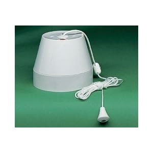

Hi,
The pullcord switch for my shower stops working every 6 months or so. The last time i changed it there was some charring inside.
My shower is 9.5kw and the switch is a 45 amp pullcord. I remember when it was changed from a 8.5kw shower, the electrician had to change the cable from the back of the shower to a thicker cable. I am concerned that this was only replaced up to the switch and this is whats causing it?
Or is this ok and it might be something else?
Thanks for any replies

If there is charring than there is a bad connection.
When you fit a new switch, you must cut the conductor back to bright copper, or it will happen again, and again.

You must cut off all damaged wire until you get back to 'as new'.

Shower pull switches are crap!
They tend to overheat and fail too often! - a better solution is a 63amp type main switch mounted in a small din-rail format enclosure outside the bathroom door, or a 45amp wall mounted double pole isolator in the rectangular format outside the bathroom door - less prone to failure! :LOL: :LOL: :LOL:
http://www.amazon.co.uk/Crabtree-2167-Shower-Switch-50amp/dp/B0048SEAAG
These are the best you can buy.
