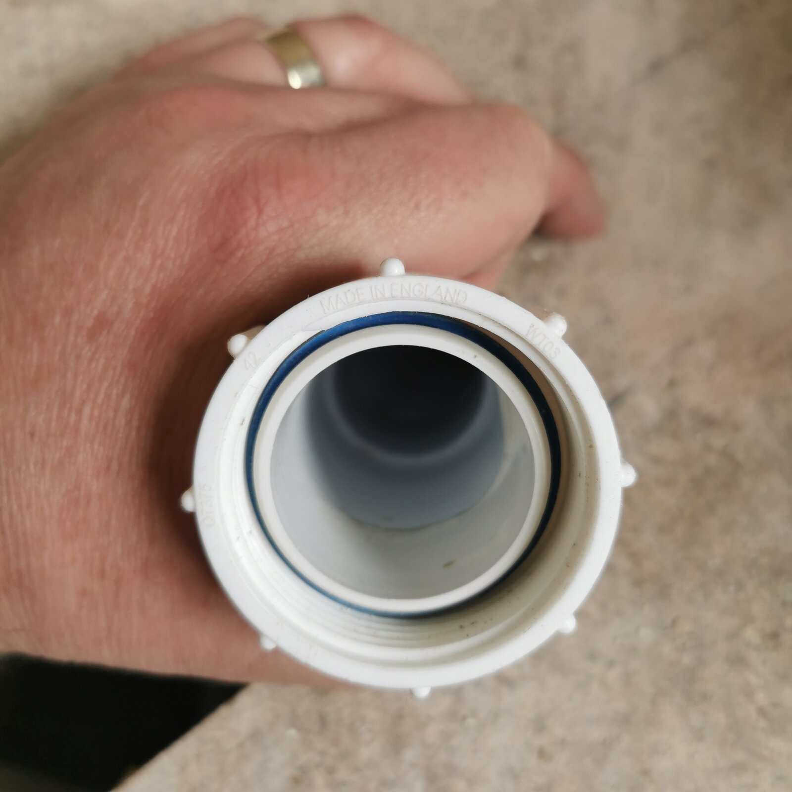

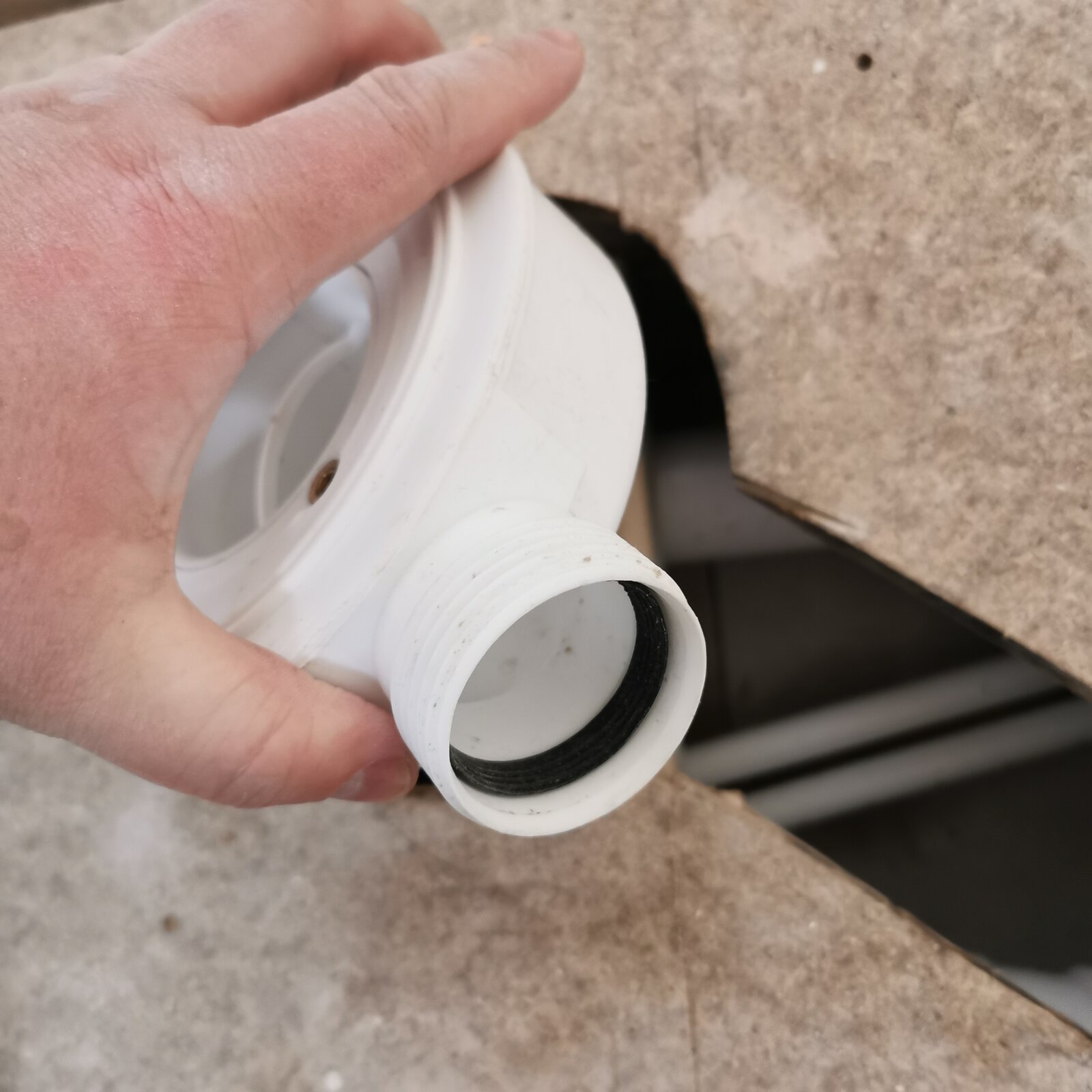

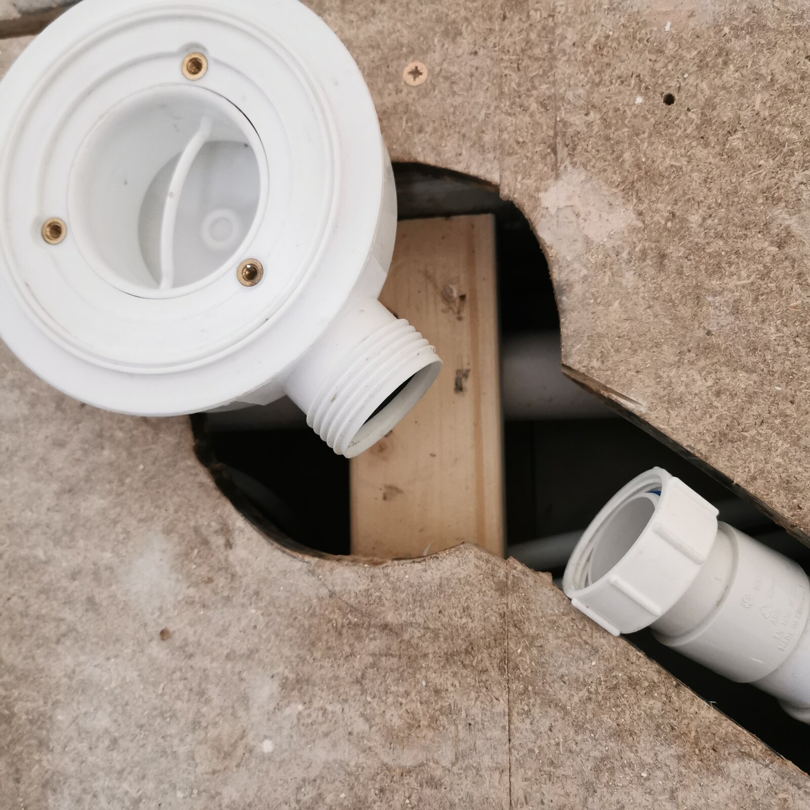

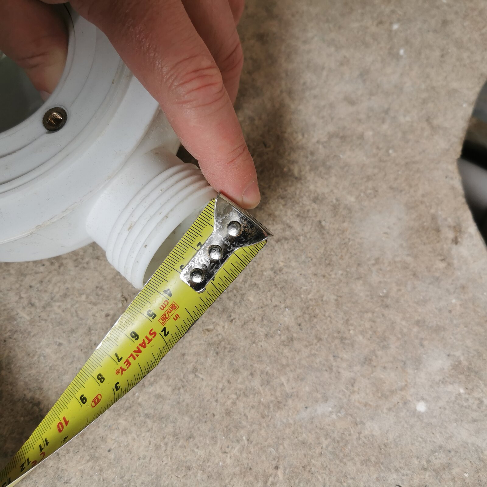

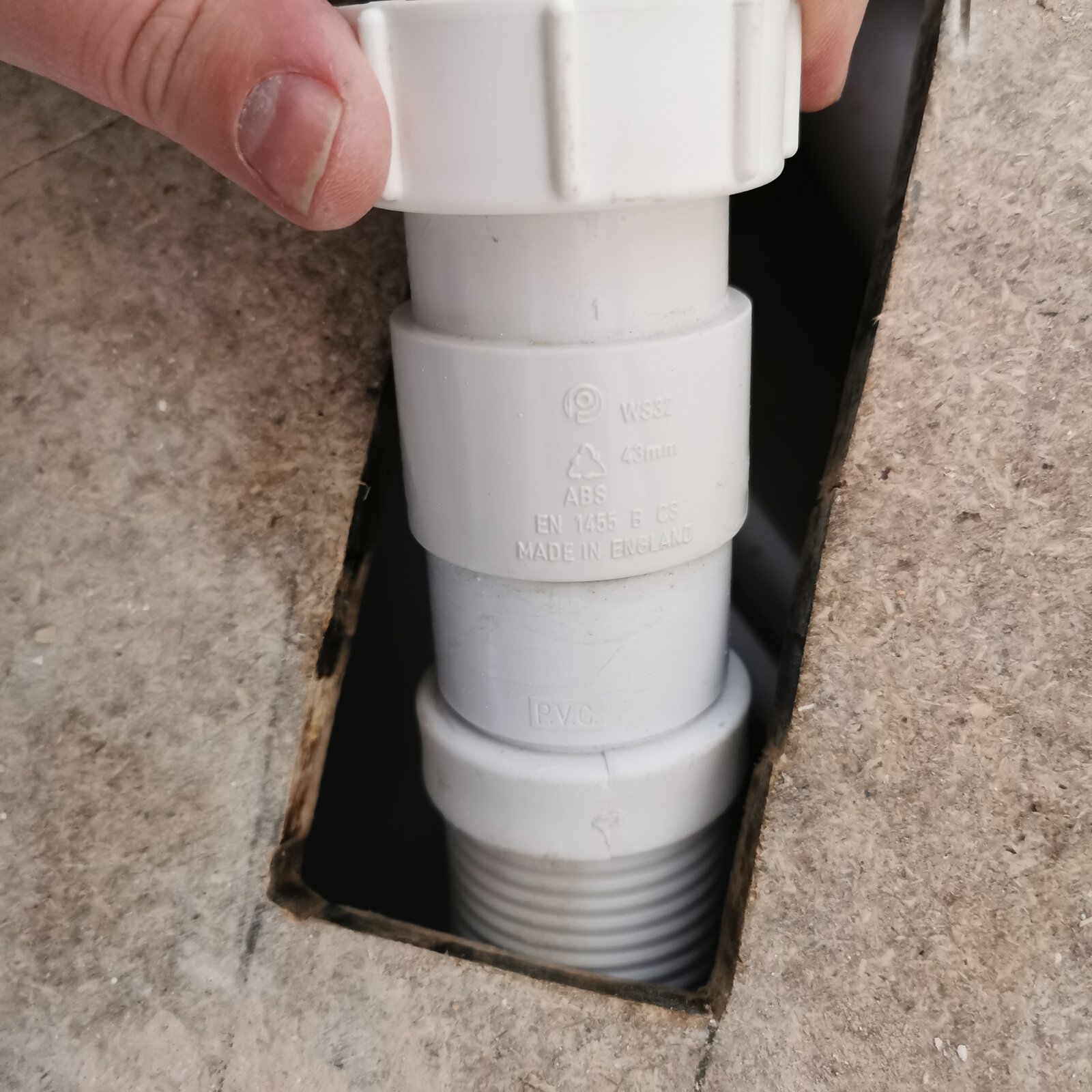

Here is a photo the compression nut has 42 on it so fits a 40mm thread. But when I tighten it water leaks out the bottom. To be honest it all screws together fine just seems to leak from below the nut when tightened. Do you think it is just me getting the seals wrong?

The T25 isn't the right end to fit the shower trap. The T25 designed is to fit onto a square ended fitting (like a sink waste) so the seal presses up square against it, the seal is held in place/shape by the small flange and the seal then compresses making it watertight.
That shower trap connection has a fluted (compression) end, therefore it uses a standard compression conical seal. The male pipe then fits into the female end of the fitting and the conical seal/thrust washer and nut then jam that conical seal into that that fluted gap therefore creating the seal. Usually they are not interchangeable.
I think the trouble you have now, looking at the pics, is that T25 is already glued onto the flexi?? It looks like there may still be enough length on the flexi end to cut that fitting off and be left with enough to fit into a compression, unless that's a PVC collar that's been added to increase the diameter of the end?
Thank you yes all welded and no not a pvc sleeve so possibly repairable. As I thought ballsed this up. I have contacted a plumber hopefully they can repair my attempts. Good job I checked the system before I laid the tiles. Shame I welded it. Thanks again all very helpful.
