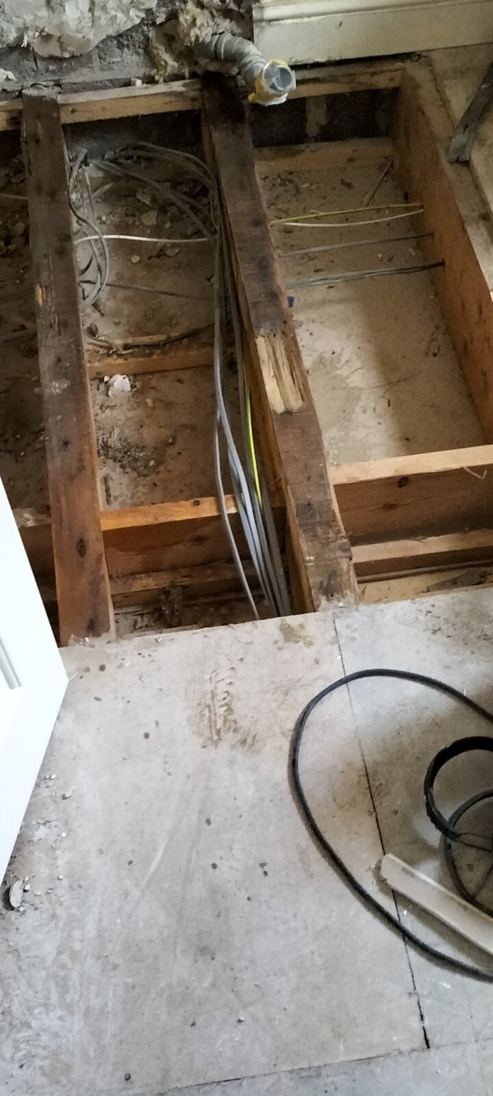

So run them so they run across the joists not parallel too.

Yup and look at the size of the feet, very little spread of the weight of the tray and person in it, so it will be inherently unstable. I have found that any movement in a tray is a leak waiting to happen.
2nd pic - option b - raised application is the plinth approach, much better IMO.
Ok if I bed in on sand and cement I wouldn't be able to panel till the day after. Even if I didn't stand on the tray.
