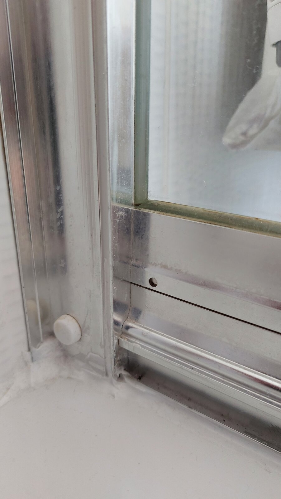

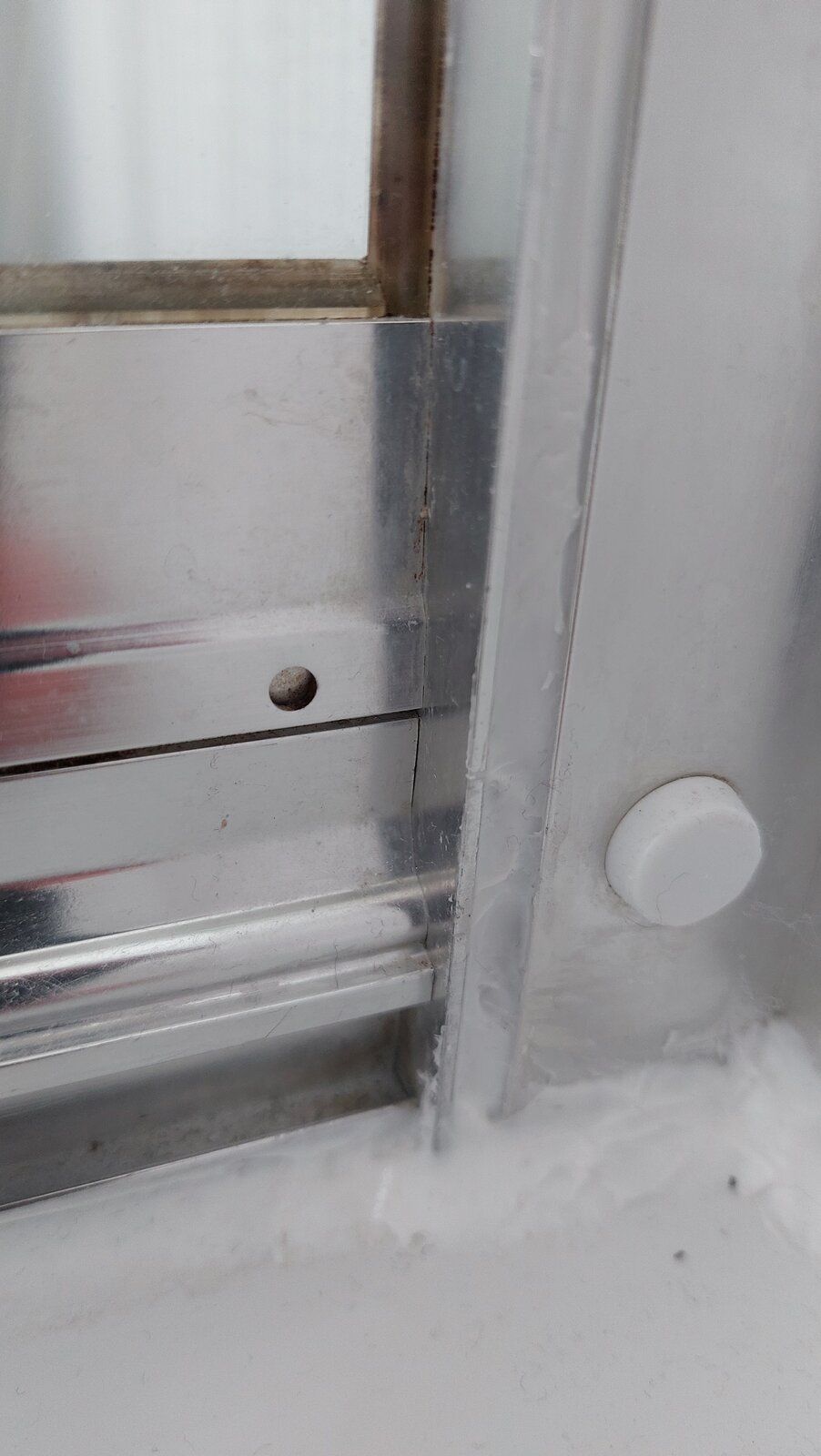

Just noticed on your image with the blue lines on (file finishing 822) , there is a hole in the aluminium bottom rail, wonder if this should have a cap on, or grommet.
Wow, that's impressive you've spotted that mate! I must have looked at that dozens of times and never seen it. Too fixated on the silicone and gaps!

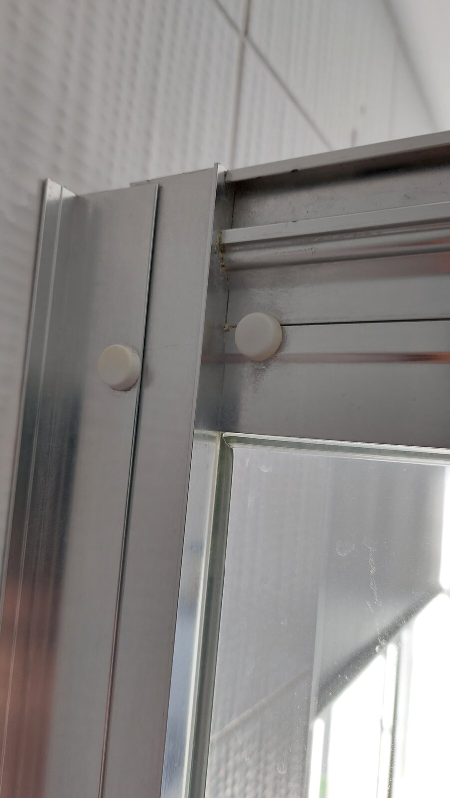

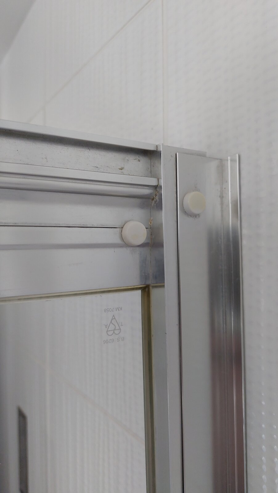

Interestingly both bottom sections have the same small hole, but the equivalent top section corners have them covered. See new photos below.
I wonder if it's that simple a fix?! Would totally make sense in terms of the localised issues.
I'm not sure if they both fell off over time or have always been like that. Maybe the installer wanted an easy repeat business to cone back to fix further down the line lol.
Any ideas what these are called and where I can source replacements?
Worst case could I take the ones from the top section as less likely to have water spilling up there?

They just look like screw cap covers to me,
Whip them off the top to try, might need a blob silicon. Alternatively stick some sellotape on them for a day or two, to see if it stops, if so you can get some spare caps.
On the B&Q cubicle's they use cams (like Ikea) to connect different sections, I suspect these may be letting in the water.
Fingers are crossed for yours! (y)
As they're on the inside, they shouldn't be an issue, either the fitter lost the screws or they there to allow the frame to drain into tray if any water gets in there.
