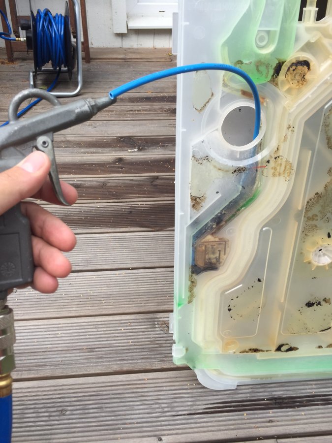

This is how my dishwasher looks like:
Tried to clean my machine today, was "impossible" to get all the grease of. But after 4h off cleaning i could see that is was letting water pass thru the "pipe".
started it up, but after 45min E15 came up again.... this time a did the tilt trick = works fine ... but only one cycle.
This is how i did:
tried too push the greas out with air and a smal hose, workd fine on the loose black particels.
this was my best way of cleaning, water from oneway and vaccum cleaner pulling from the other end.
finish!
