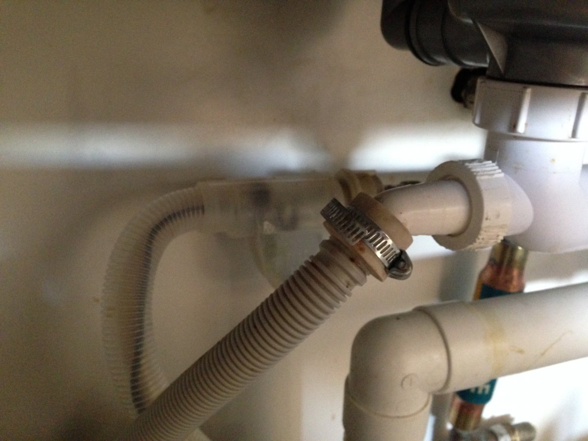

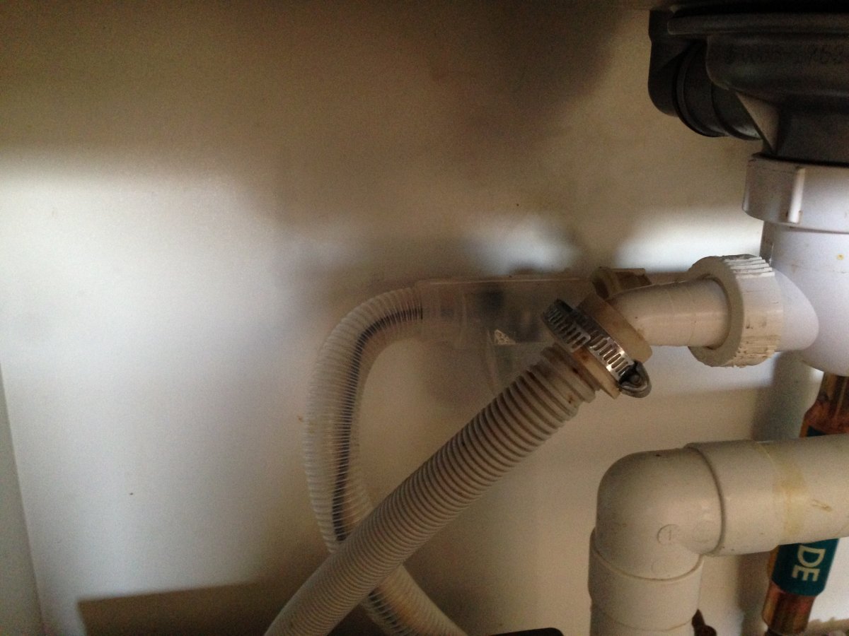

Also as this is inset as part of the kitchen, I can't get this out to 'tilt' as others have said, but have found two pipes going to underneath the sink, to the waste?
I have attached photos, and think the only way of unblocking any food in the waste (which maybe giving the Error code) is to un-attach from sink and pump water through the pipe and back into the dishwasher? then mop it out from the DW directly?
It was originally full of water in the bottom sitting there, but now its ok after clearing it out manually.
From the pictures below, I have a single pipe and another pipe with the attachment on? Not sure which is which and which one is the waste pipe? (that maybe blocked?)
Thanks for any help :

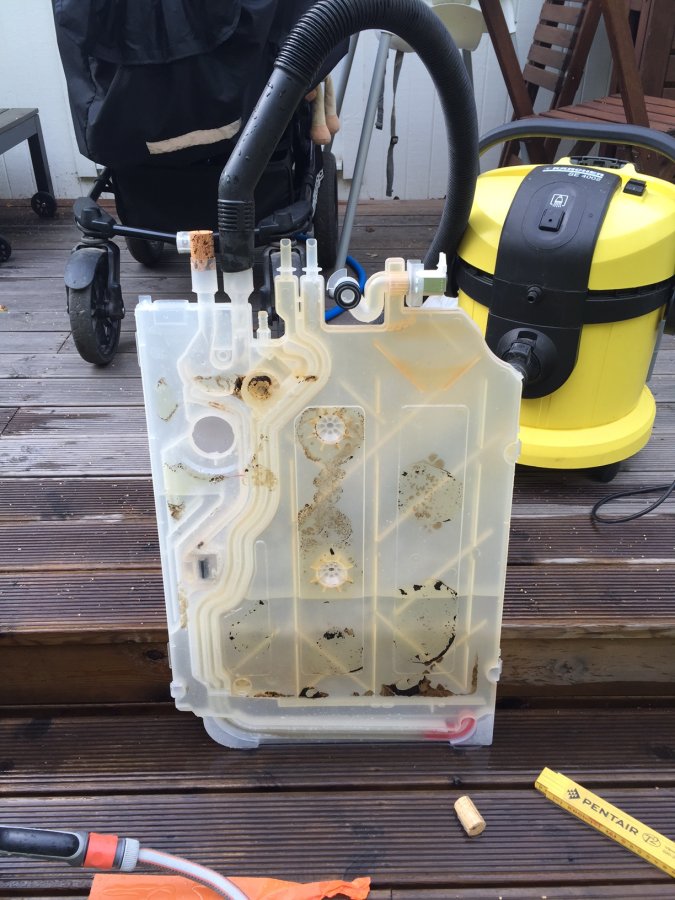

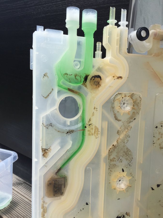

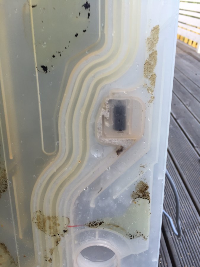

Tried to clean my machine today, was "impossible" to get all the grease of. But after 4h off cleaning i could see that is was letting water pass thru the "pipe".
started it up, but after 45min E15 came up again.... this time a did the tilt trick = works fine ... but only one cycle.
This is how i did:
View attachment 103247View attachment 103250
tried too push the greas out with air and a smal hose, workd fine on the loose black particels.
this was my best way of cleaning, water from oneway and vaccum cleaner pulling from the other end.
finish!
