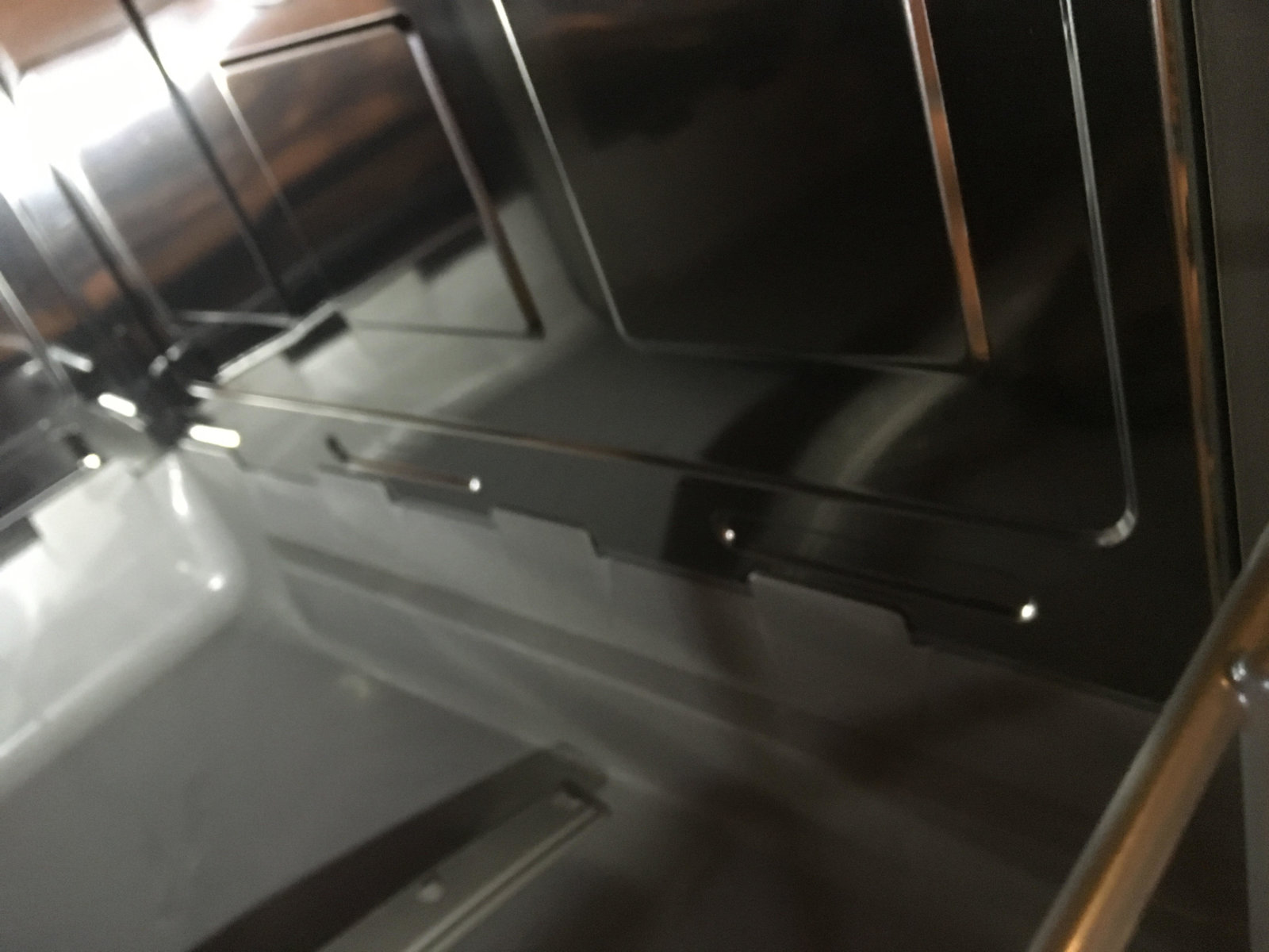

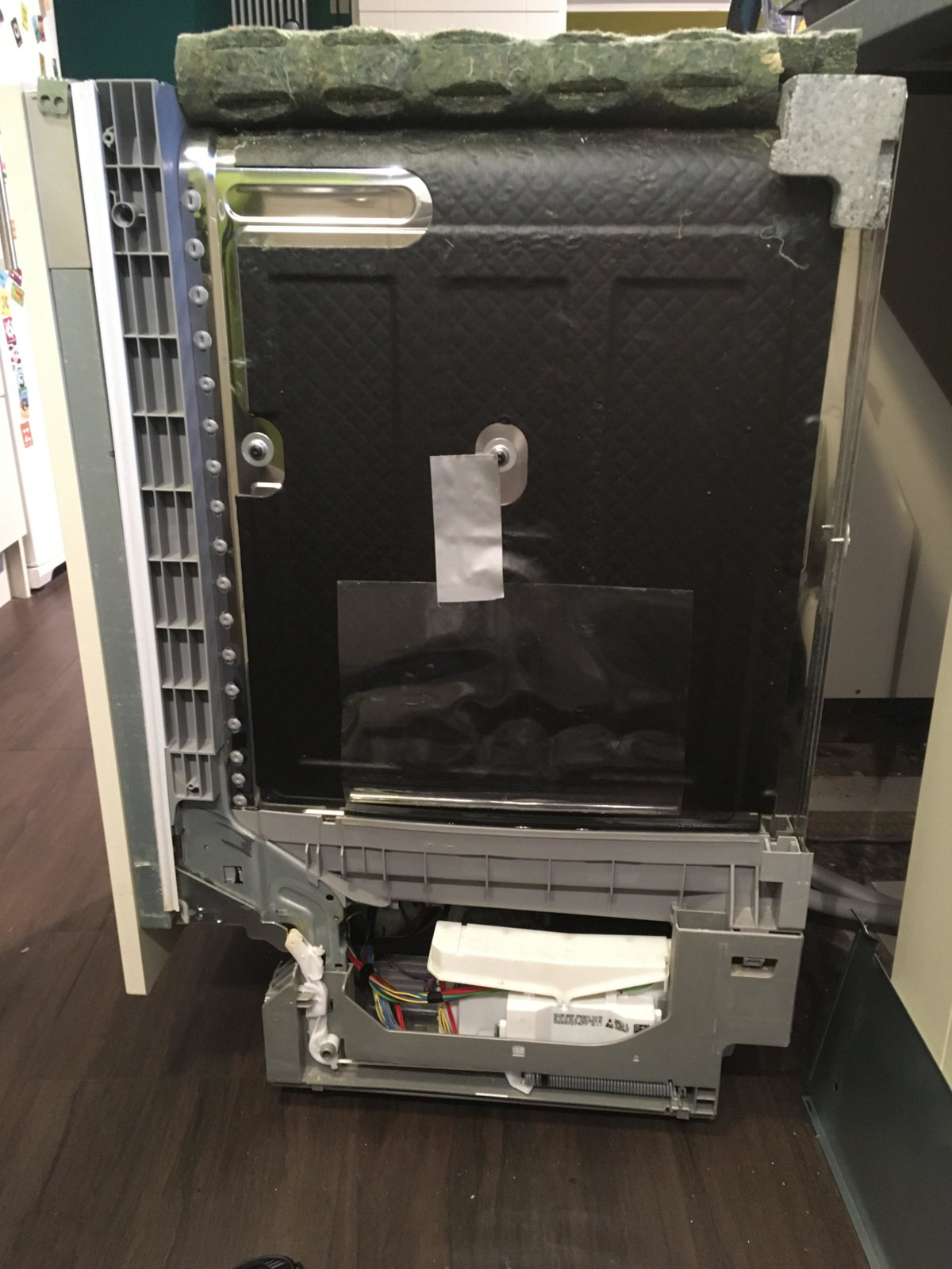

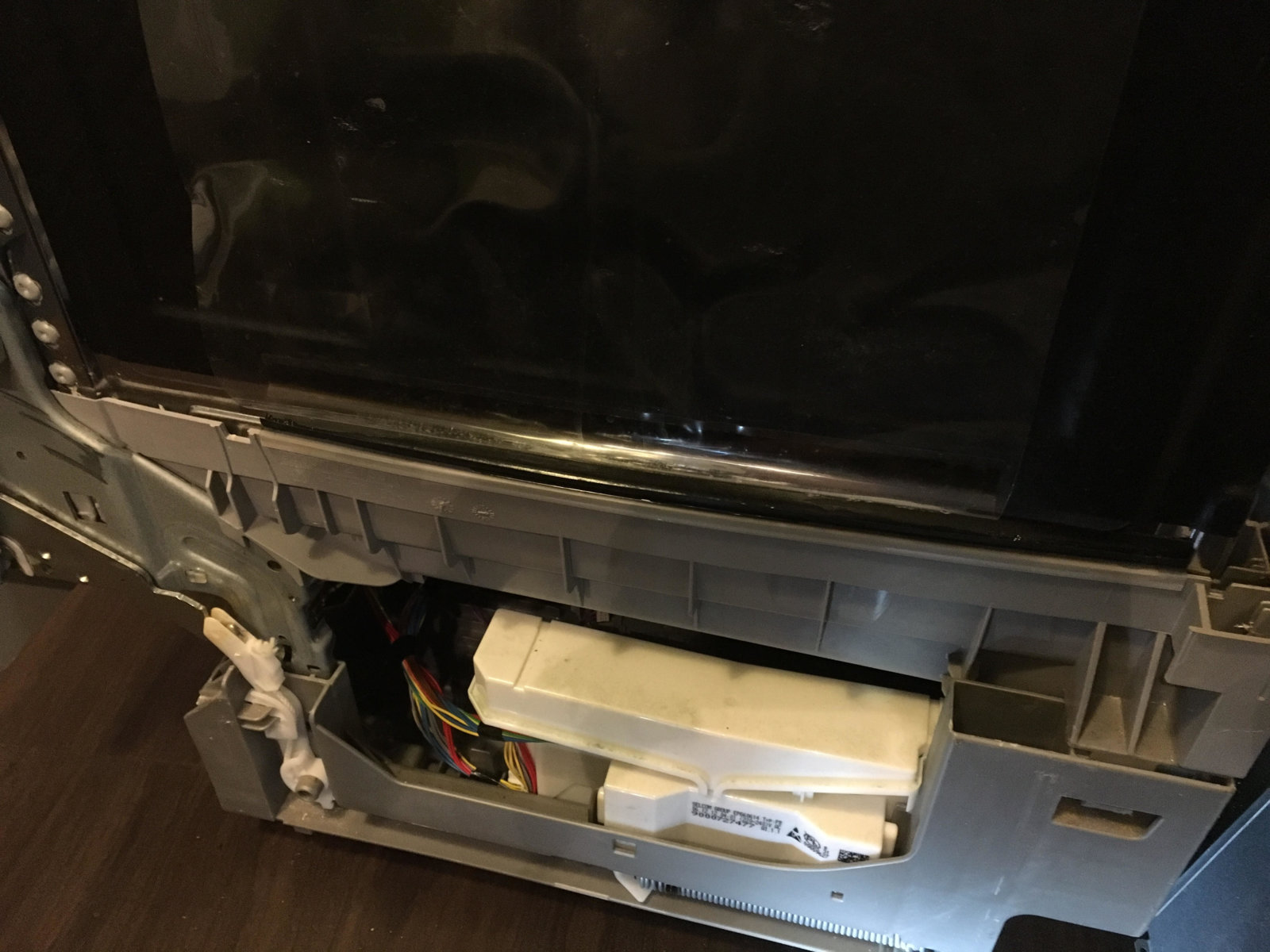

Hi All,
I have an integrated Siemens dishwasher which has been displaying the e15 fault and she enough the bar of the machine is filling up with water. Having had a good furtle round the leak is coming from the join between the plastic internal base and the metal sides.
Any ideas whether this might be a level switch thing or is it just a seal failure. The side of the plastic base seems a bit bowed to me
Pics below
Just for future reference for others spoke to an independent repairer who said it's not repairable...
Plastic internal base with stainless steel sides? Sounds like a recipe for eventual failure.
Has the build quality gone down on these things?
I just repaired a 18 year old Bosch and a 15 year old Siemens (identical innards) . Both as good as new and all stainless steel interior. Built like tanks.
