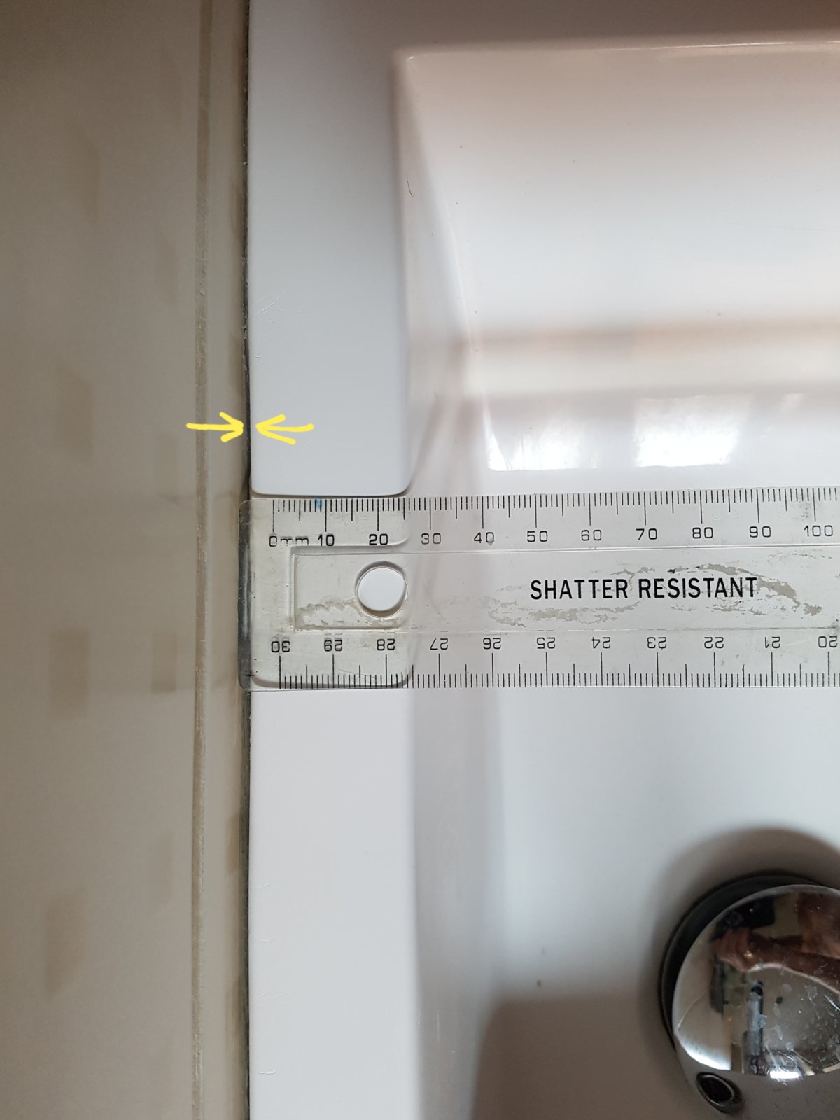

Maybe its not as big a gap as it looks in the picture?
Well it's about a 1.5mm gap, like credit card width, very tiny to fit any bead in there.

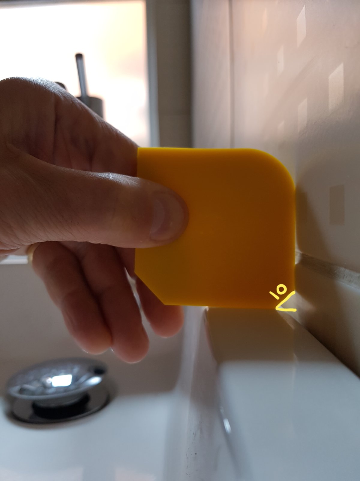

And then the profiling tool edge is 10mm at 45 degrees, and the horizontal distance between the profile edge and wall must be similar or maybe a bit less.
Maybe I should just go for it at a 10mm nozzle cut?
Yes go for it then, have pieces of toilet roll torn off ready to keep wiping the spatula of any build up and a bin to throw them in after cos it can get messy..good luck

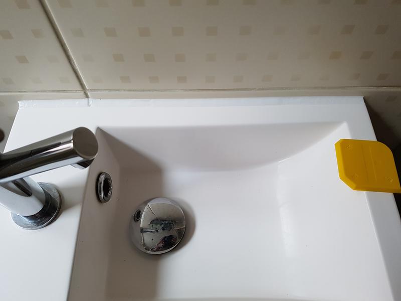

Well, after a little practise inside a cardboard box and getting used to it, I finally did the basin.
I had to pump some more over what I'd done as there wasn't enough in places, it takes some practise feeling how hard to push the trigger.

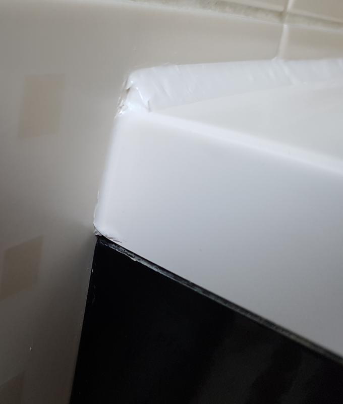

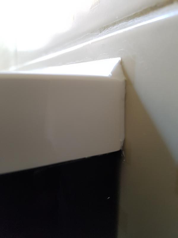

Struggled on the end bits and sides and I didn't get as much silicone there as I did the sides with my finger.

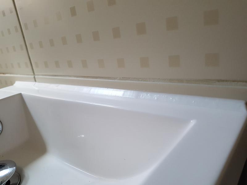

Well, here it is. *puts hand over face from embarrassment *. It's a bit rough lol. I probably need to do it again, or go over bits, or is it ok? o_O
I couldn't avoid the silicone shaping itself into that grout line.
