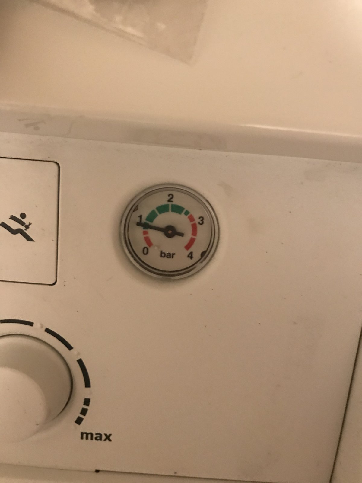

Me again I’ve noticed over the past week that when the boiler is cold it is sitting just below 1 and then when working full pelt is getting to just below 1.5 ( this was the pressure the installer left it at when he installed it) but I’ve also noticed that while it’s on, say the 6-9 slot, once the water and room is up to temp the boiler switches off which is right but then when it comes back on the pressure may be back to just over the 1 is this right or should it be holding the just below 1.5 pressure for the duration of the 6-9 period?
Hi, the pressure rise and fall is down to the expansion of the system water, as it heats up it expands more, most of this expansion is absorbed by the expansion vessel, if the pressure starts to go much higher than 2 bar its probably an indication that the air pressure in the expansion vessel is getting too low and needs to be checked. When your pump starts & stops can often cause the pressure gauge to jump.

1 to 1.2 bar is normal when cold, if pressure drops below 1 it needs topping up this should happen no more than once or twice a year unless you need to bleed your rads excessively.
Mine seems to be sitting just below 1 when cold or on starting up?
Many boilers will lock out if the pressure drops below 0.8 bar so it might be a good idea to top yours up to 1.2 (when cold) using the filling loop.

Ok so this is what my boiler is sitting at just now, heating went off at 9 came to check it just now and it was sat 1. Then the dishwasher asked for water (connected to hot water feed as y branch didn’t work for us and just leaked everywhere) and this is what it’s sat at? Sometimes when it first starts up it drops to that as well but then it will rise to the just below 1.5 no problem
