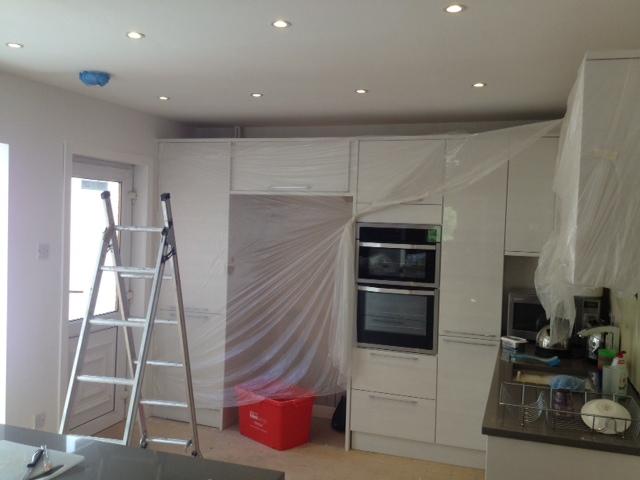

We just (2 weeks ago) had GU10 LEDs fitted in the new kitchen and they work extremely well. Not very narrow beams as I've seen with other people's downlights.
Interestingly, the electrician just wanted to fit 12V traditional downlights and I insisted on having dimmable GU10 LEDs, following advice from this forum.

I have been in plenty kitchens where the downlighters look like a 50p torch pointed at the floor. What we've just installed are in a different league.
I did argue with both the architect and the builder, but the electrician was adamant that they would be fine.
And they are.
Sometimes you need to look beyond the spec sheet and the earlier incarnations - progress can be made!
