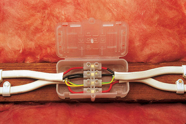

Could someone explain what a choc-box is and why it might be necessary or useful. Could you direct me to one in a catalog eg. Screwfix.

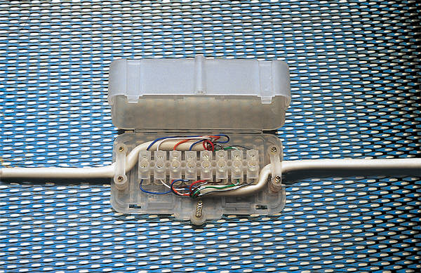

If you meant choc-box and not choc-block, that's these:
And you need them because terminal strips should not be used without mechanical protection.

Where can you get those, Ban? Never seen them as far as I can recall
[the choc boxes I mean]
