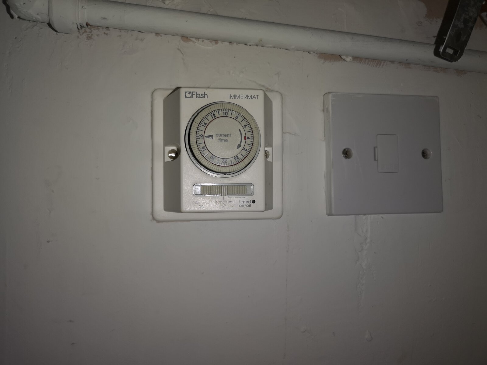

Hi,
Looking for some advice please.
My current set up is as follows :
Conventional gas boiler with a flash immersat timer switch, heats the rads and hot water tank. There is one thermostat in hall which will switch off rads when temperature exceeded.
I would like to have a wifi timer switch that i can control the on / off of my boiler remotely as I am away at random times for random durations.
Ideally i would like to just replace the flash switch with a wifi enabled switch but everything i see online seems to come with a smart thermostat. I dont really need a new smart thermostat and while I am not against getting one, i dont see how it would fit my system becasue if i want to heat my water, currently i just switch on the boiler and turn down the thermostat. With a new smart thermostat presumably the boiler will not start when the room temperature is already above setting. If my system would work with a new thermostat I am happy to get a wireless one to place in main living room as that would be better than the current hall location.
Could you advise some simple solution ?

I looked at your flash immersat timer....I take it your system is fairly old (gravity hot water, no motorised valves or other fripperies?)
You could replace that timer with a WiFi smart 13A socket and keep your existing thermostat etc. Basic wiring skills only, not sure whether such a setup is permitted in Ireland but it would work.

Photo attached of current timer located on Wall directly under boiler.

It is not recommended to use a plug and socket for an immersion heater. There is a risk of it overheating and starting a fire.
Immersion heaters should be hard wired.
The TP link device has a max load of 2.99Kw. Most immersion heaters are 3Kw. I would not risk using a device that is on for a long time at or above its maximum load.
Could you change the spur for a single socket outlet, power the boiler through a plug, put the heating and/or hot water on permanently when you go away and then just power the boiler up with a WiFi plug to turn the system on when you want?

Well, if you don’t know much about electrics, I’d seriously suggest that you get a qualified electrician in. If you don’t want to go to full remote control hive/nest type of setup, a simple on/off WiFi plug would be the cheapest option or even a WiFi spur if you are keeping your existing controller. It does sound to me that you will need to get an electrician in though.
Thanks, I don't mind getting an electrician, i just want a simple solution that works, even if that simple solution means getting an electrician that's fine. Although I could replace a spur with a switch I'm sure, I just wouldn't be sure about some of the other solutions suggested in the thread.
It's not that I don't want full remote hive / nest - I just don't see them fitting into my system without a workaround.
So the WiFi spur seems like a good and simple solution, any pros or cons over a WiFi plug, the wiring seems easier for the WiFi spur.
The electrical rating of boiler is given as 125W, internal fuse 2AL,external fuse 3A, so would i be correct in saying that WiFi spur would do the job?
