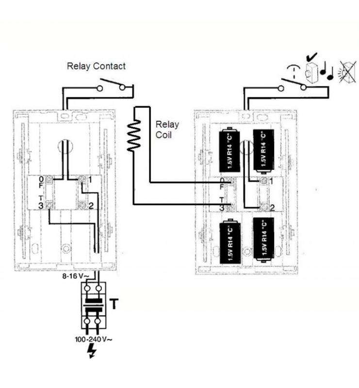

And with the addition of a relay it works! Wired as shown in John's diagram with the relay.

This is a diagram with both connected using the transformer that caused the buzzing.

I think using this transformer at the garage is probably confusing the issue. When you use the relay, the batteries at the garage supply only the garage chime and the relay switches it locally - so if that chime works with the batteries and local activation, it also will work with the batteries when activated via the relay. What you need is to get the relay activating properly.
Whatever you do, I would suggest that you don't try using that 8V AC transformer to power the front door chime whilst you're using the relay at the garage end. If you got the one I suggested, it's a DC relay and has a maximum rated voltage of 6.6V. Fed from an 8V AC supply, it will probably make a hell of lot of buzzing noise, probably won't work and might get damaged.
